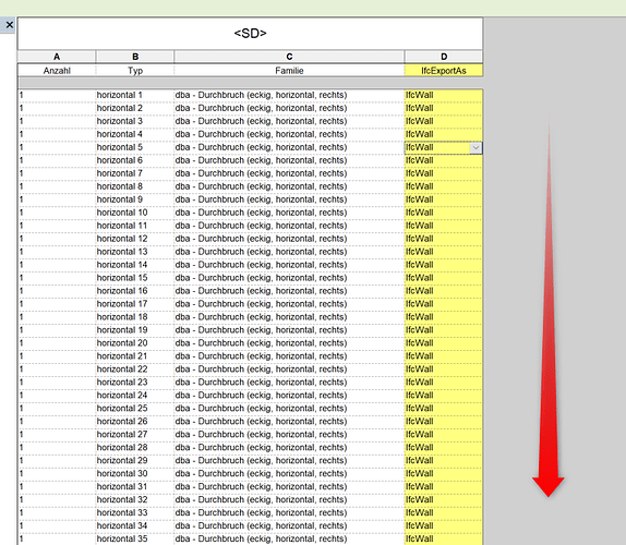

Import from Excel TypeParameter how?
I want just overwrite an TypeParameter, how?
actually i used import from excel just for instanceParameters…
is there anything to take in mind for edeting typeparameters as string?
Projekt_IFC.rvt (3.4 MB) ImportExcel.dyn (25.7 KB)
KR
AndreasSD_Import.xls (91.5 KB)

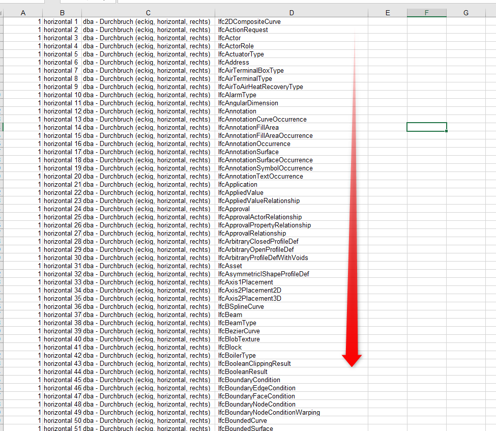

the real task is to attribute 653 opeinings with all IFC-classes and Export them, because i want to see which classes confert IfcBuildingElementProxy into an other IFC-Class.

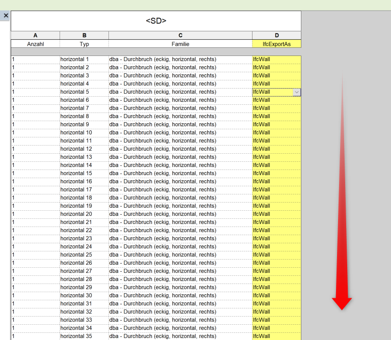

@Draxl_Andreas Can you please share the excel file?
Since it’s a type parameter. See if this points you in the right direction.
@Draxl_Andreas Here you go
ImportExcel.dyn (26 KB)
