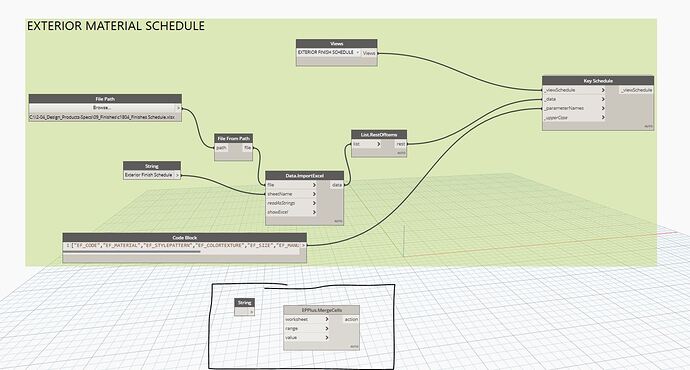

Hello All,
I wanted to import excel to revit as a key schedule. I did it,but I have a problem with merging cells. I want to merge 2 rows or 3 rows. I found a node that name is “EPPlus.MergeCells”, but I could not find how to connect each others. Also I want some of text to be bold. If someone knows the solution, can you help me?

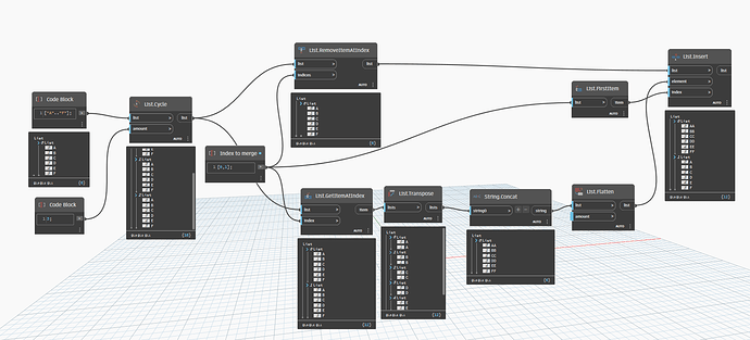

are you tried to merge sublists (rows) instead
a simple example
Hello, thank you for your respond. I assumed that I need to tie “List. Insert” (from your respond) and “List.RestofItems” (that is in my combination) with binding node. And I need to tie all of them to “data” in the key schedule. However, I could not find binding node. Do you have any idea? Thank you again.
