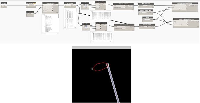

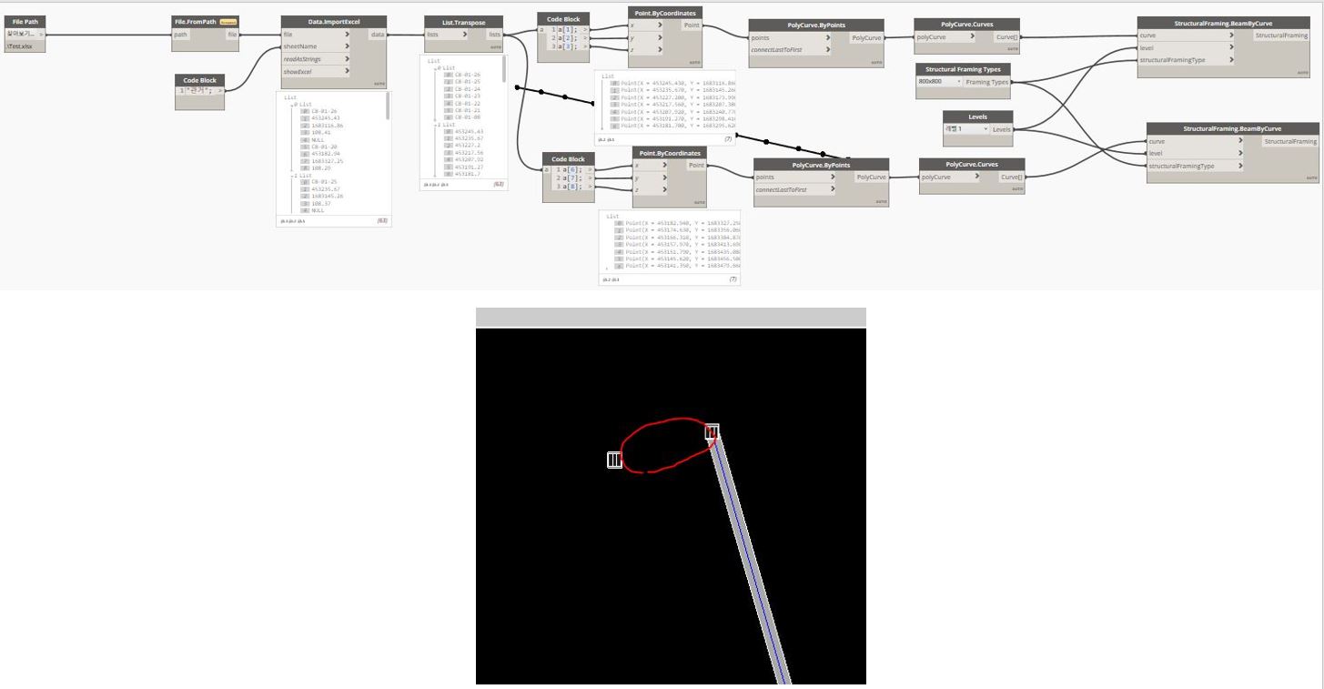

I made simple test logic for a making frame model.
But, only 1 short curve wasn’t created.
Why?
Plz let me know any idea.
Thanks and Regards,
Without the data set it’s hard to know why, but beams under a certain length can have their entire massing removed by the attempted connections. Worth reviewing the start and end points for the one failing member in isolation.
Oh, you’re right.
Model is made after when I isolated short curve data.
Thanks :slight_smile:
