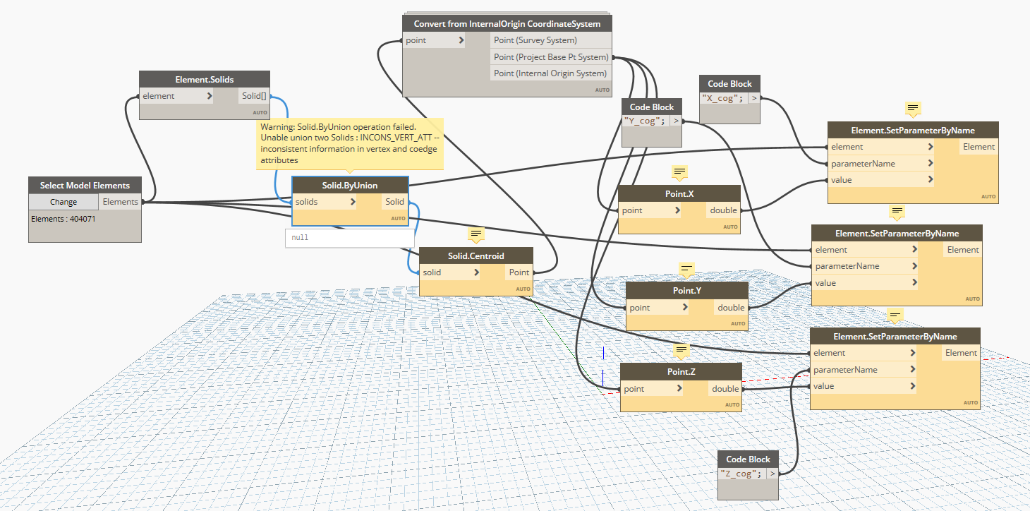

I am getting error as in the attached image, while i try to get centroid values for door family files.
It shows that solids did get made as union.
I have checked and found some lines (lines needed, should not delete) only cause this error.
So, how to ignore lines to get solids only?

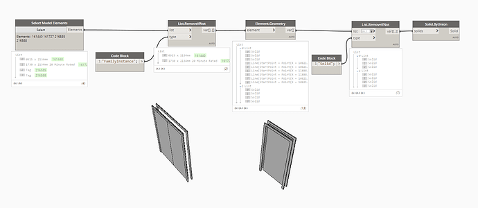

You could use Object.Type or Object.Identity to retrieve the object’s type and filter it? There might be a custom node for this aswell.
Thank you @Rickkrrd .
Let me try this and come back.
Why bother grabbing the lines if you don’t want them? Assuming your previous node was Element.Geometry, swapping it for Element.Solids could make quick work: Dynamo Dictionary
Or you can use the List.RemoveIfNot node :slight_smile:

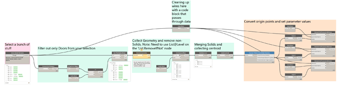

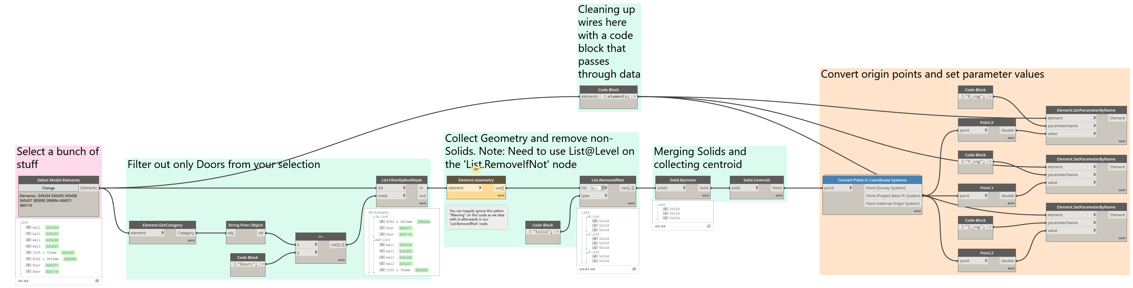

Hi @velraj.a - I think I’ve solved your problem as below:
Velraj-COG_for_Revit_Elements.dyn (39.7 KB)
