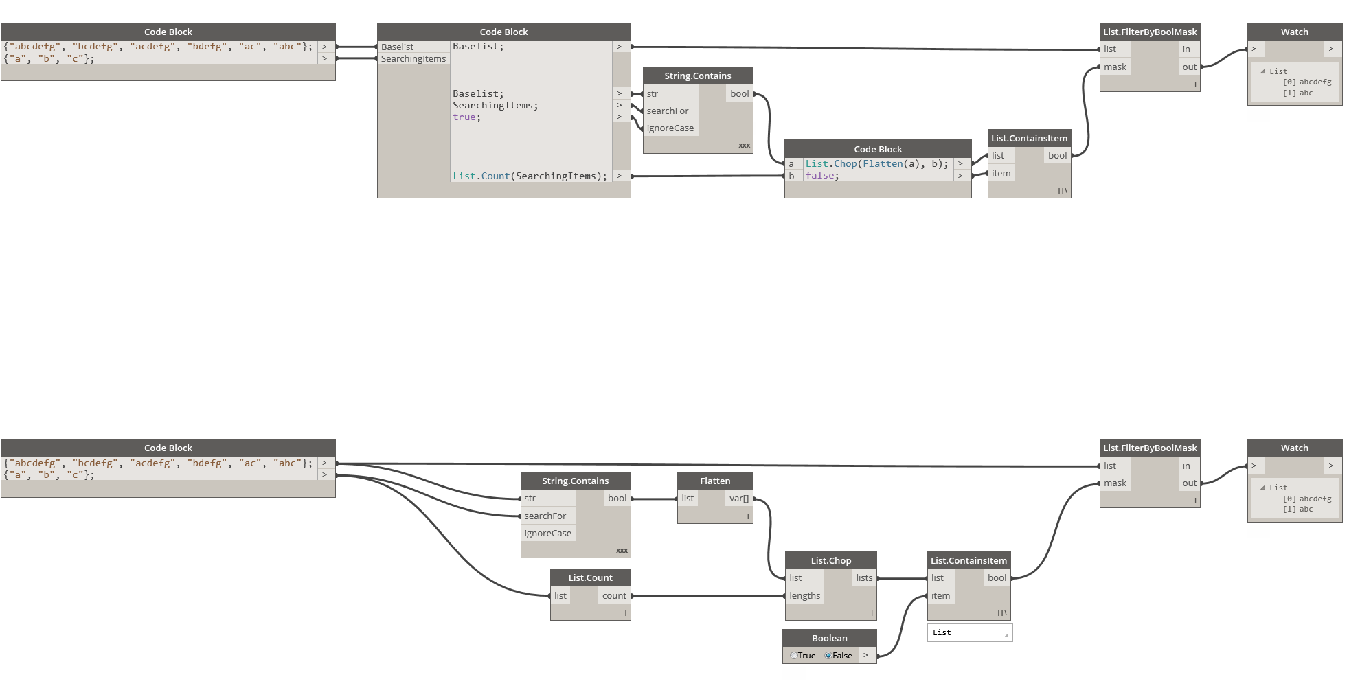

That won’t work as the context of the syntax is meaningless. I’m not sure if that nodes takes a list input, if it does change your codeblock to {"Boundary", "Masking"}; otherwise you will need to perform the operation using a two step process (i.e. Search for the first string then connect the output to another String Contains node to search for the other string.
Yeah, no it doesnt work. Ok I already had the two step process in place, just trying to simplify things. haha
if you only have two then run the two step process… if you’re looking 3 or 4 or X items this should help.

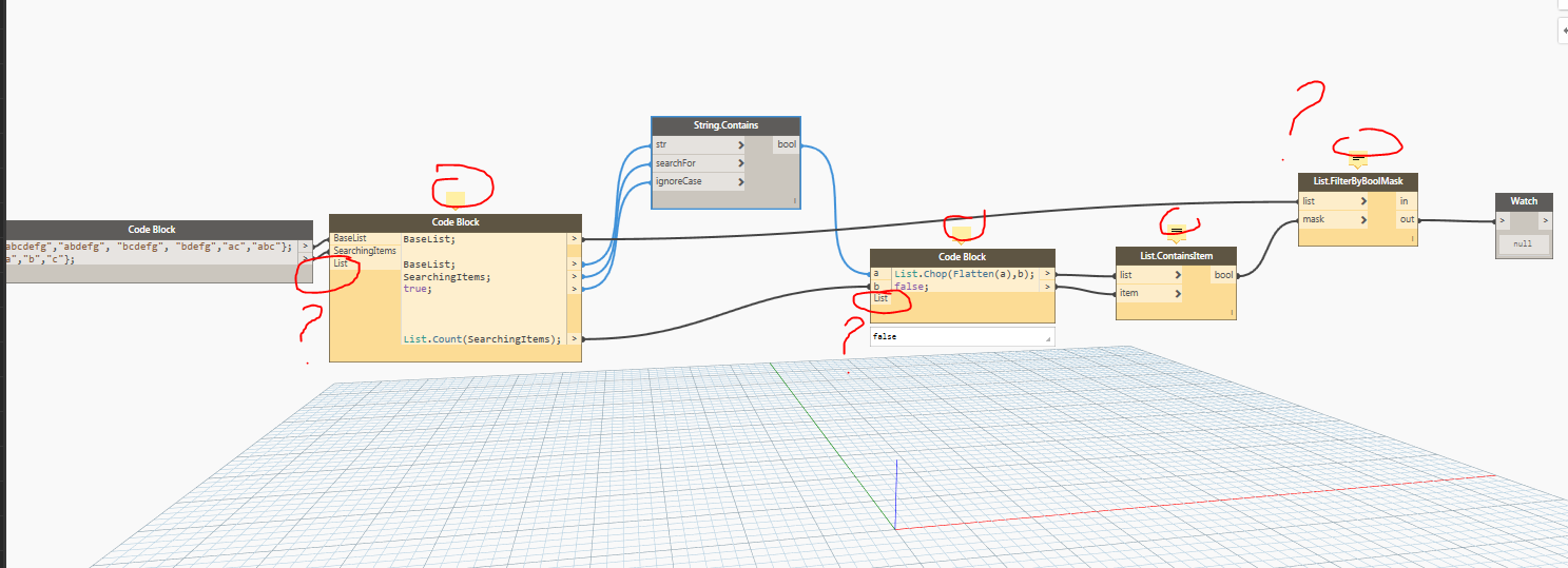

Im not getting it to work. Seems like dynamo is creating my code blocks with this bolt on list in my code blocks which is different than yours but I dont know why. Please advise.
This looks like a glitch in Dynamo itself.
Try restarting Dynamo in sandbox mode (not as a revit plugin) and giving it another go from scratch. If that doesn’t work post the results here and anyone else who opens it can check if it’s a coding issue on your end or an installation problem.

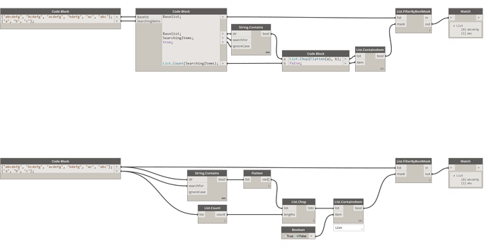

If it’d require a reinstall or other time consuming task or you need IT to run the install, you can also use the OOTB nodes which I call on in code blocks to produce the same result.
