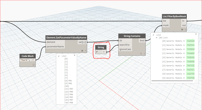

i am in need of some assistance again. I need to filter l elements, where the value of the “Mark” parameter contains contains either “P” OR “W” (red circle below). Does anyone know how i can accomplish this?

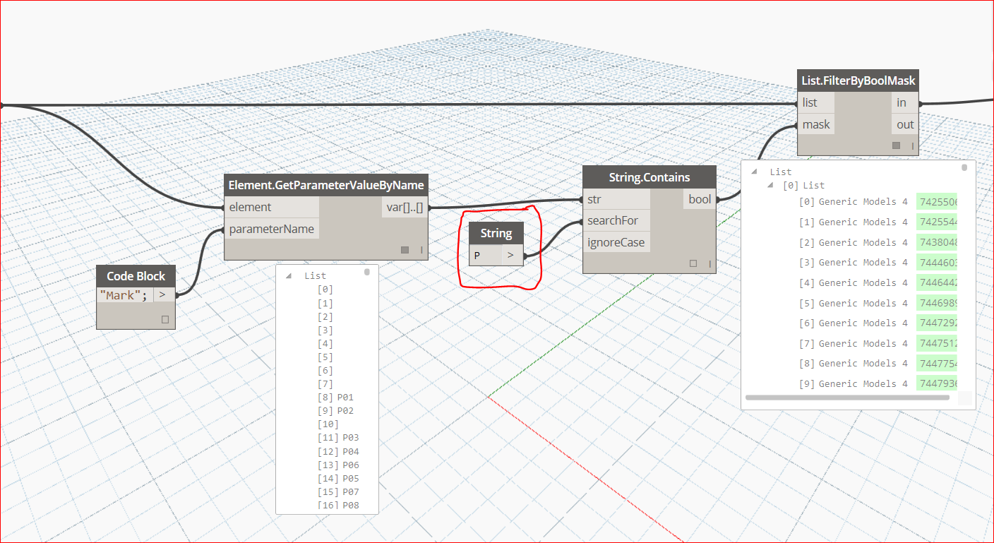

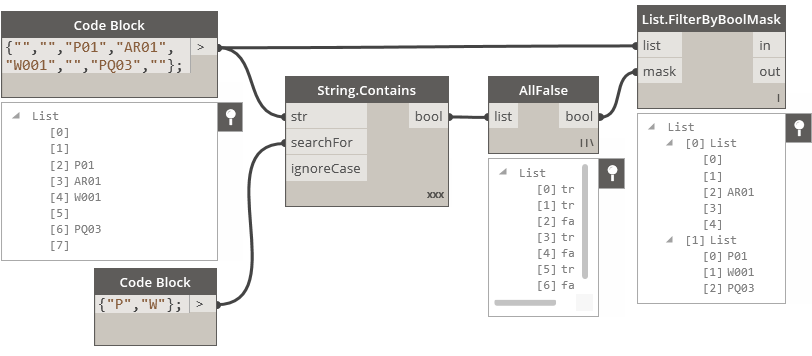

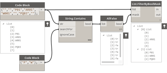

The design script for boolean “or” is “||” you can dump it in a codeblock.
There might be a more elegant solution but this has worked well for me:
I see what you did there. Worked like a charm. Thank you!!
