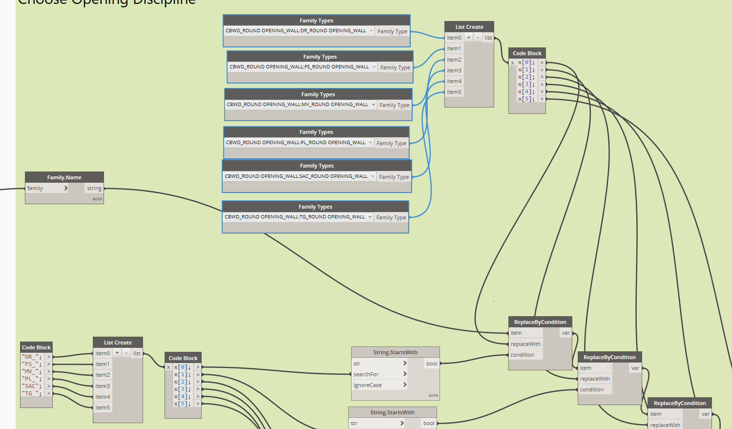

I can see the potential of Code Block. There is a similar case that I have to repeat with a lot of same nude and I fail to use “list.create” as the “ReplaceByCondition” doesn’t support getting index. Could you teach me how to simply it by using Code Block?
@TCKEAHY Try this:
DSCore.String.StartsWith(fn,sw[0],false)?ft[0]:
DSCore.String.StartsWith(fn,sw[1],false)?ft[1]:
DSCore.String.StartsWith(fn,sw[2],false)?ft[2]:
DSCore.String.StartsWith(fn,sw[3],false)?ft[3]:
DSCore.String.StartsWith(fn,sw[4],false)?ft[4]:
DSCore.String.StartsWith(fn,sw[5],false)?ft[5]:
"Not a match";
