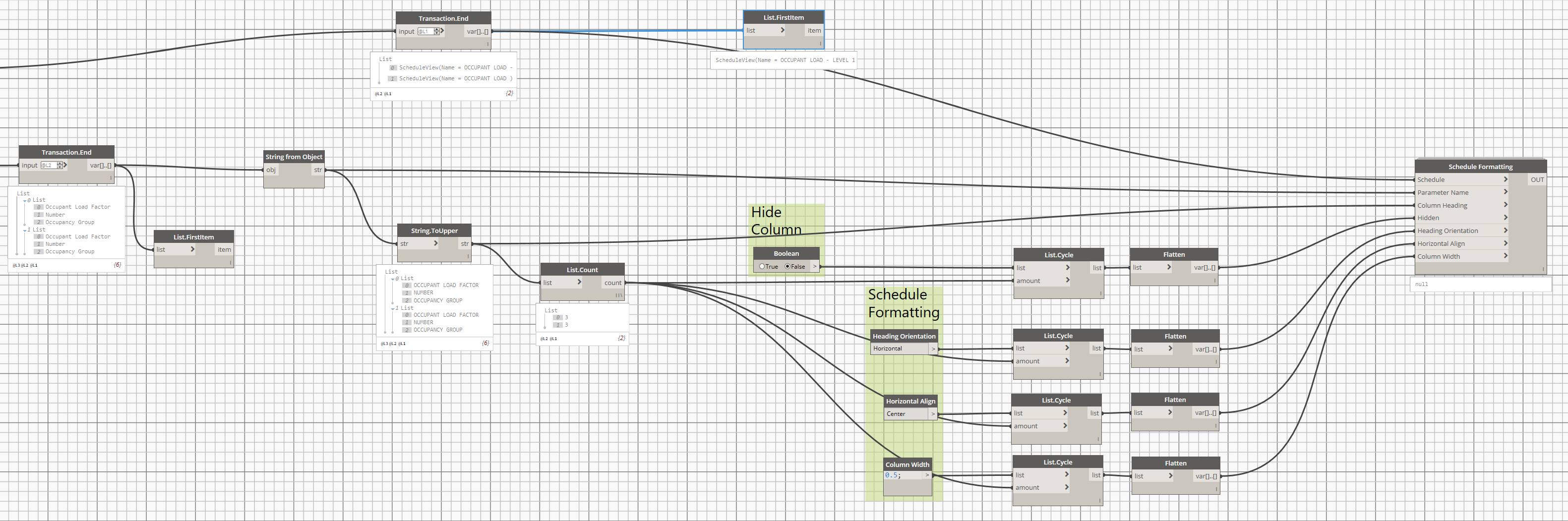

@Konrad_K_Sobon. Does your Schedule Formatting node work for multiple schedule inputs? It seems to be working for one ScheduleView input:

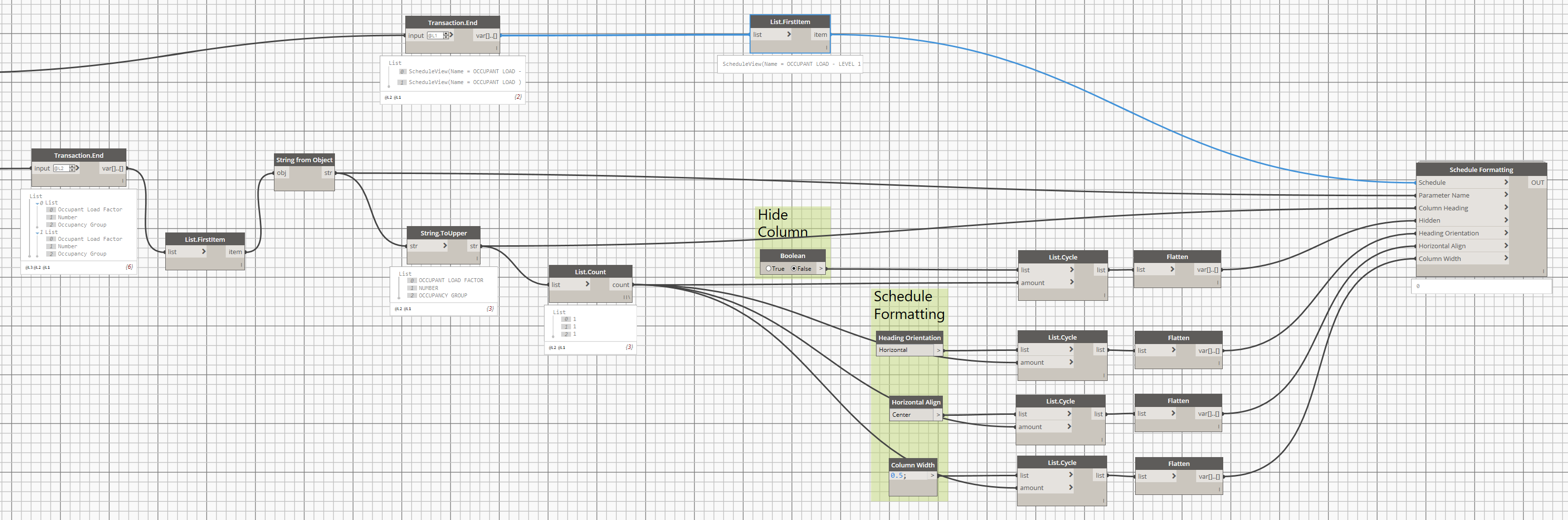

…but does not like multiple ScheduleView inputs:

That’s possible. It must have been a while since I touched that particular node and I don’t recall ever scripting it for multiple. Did you try lacing?
