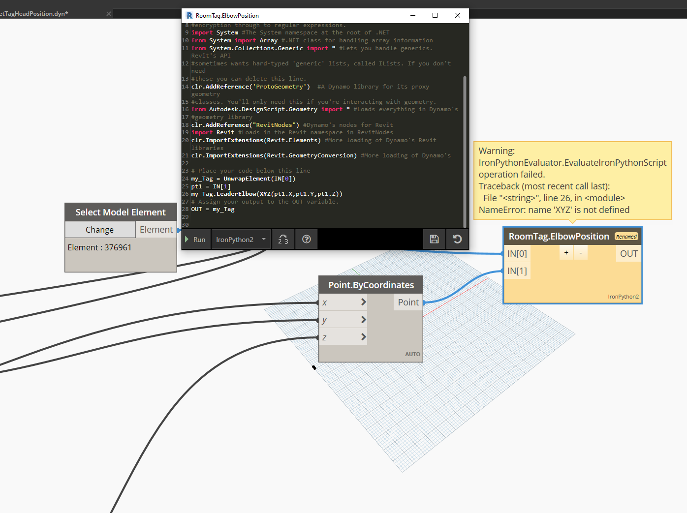

How to set position for LeaderElbow in Python?

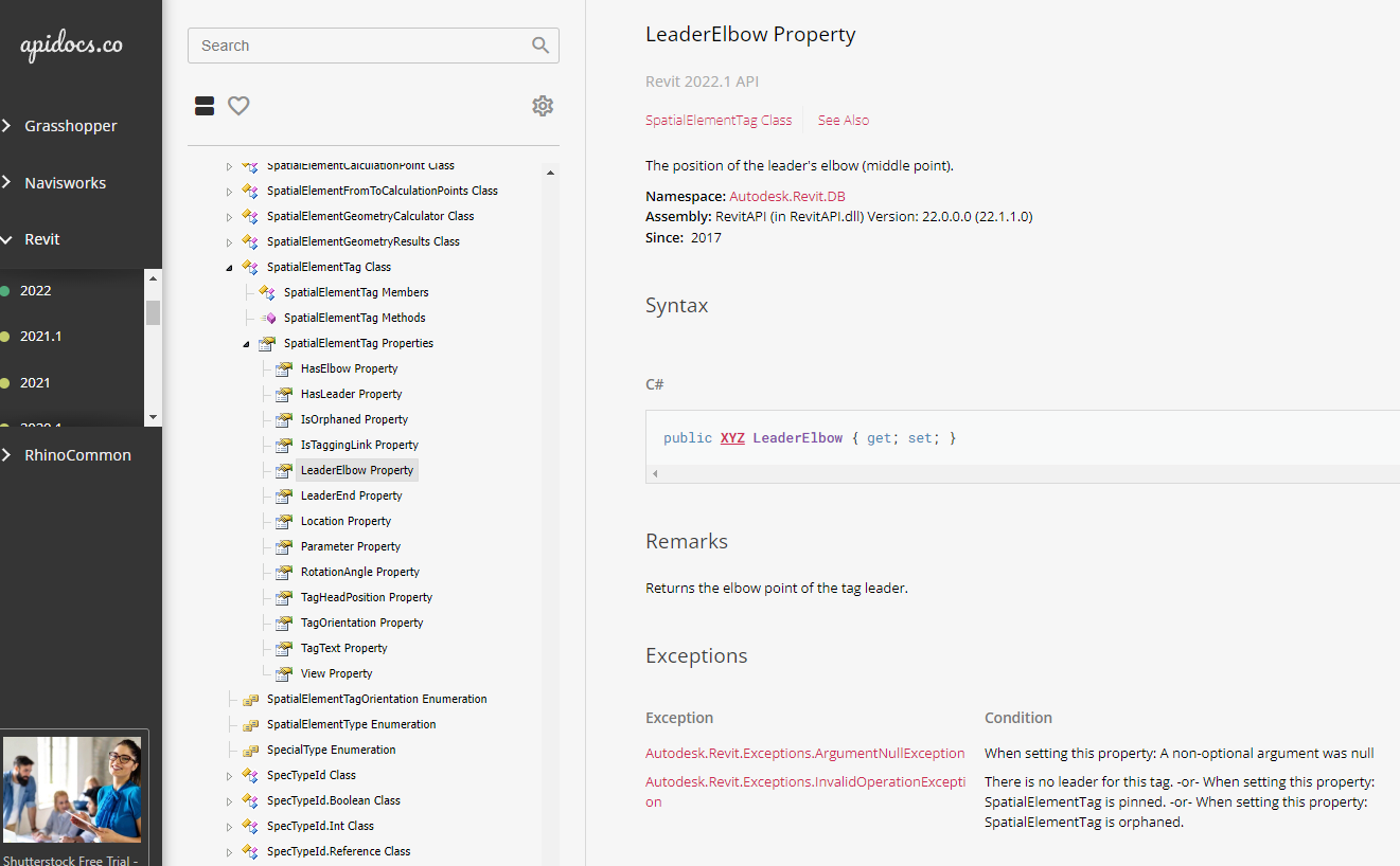

Where can I get which parameter and type a method needs in Python?
In API Docs I just got the name of the method without parameter or an example

It’s wanting a Revit point, so use the XYZ() wrapper.
XYZ(pt1.X,pt1.Y,pt1.Z)
XYZ got an error. Firstly, I think it from Revit so I import Revit library and it’s still not defined.

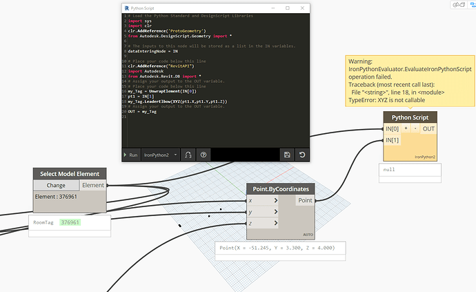

clr.AddReference("RevitAPI")
import Autodesk
It turns to “Not callable”.
I got it! 2 things I miss:
  1. import Autodesk.Revit.DB
  2. open/ close a transaction for process
    We need to put the process into a transaction open and close because these changes affects Revit File.
