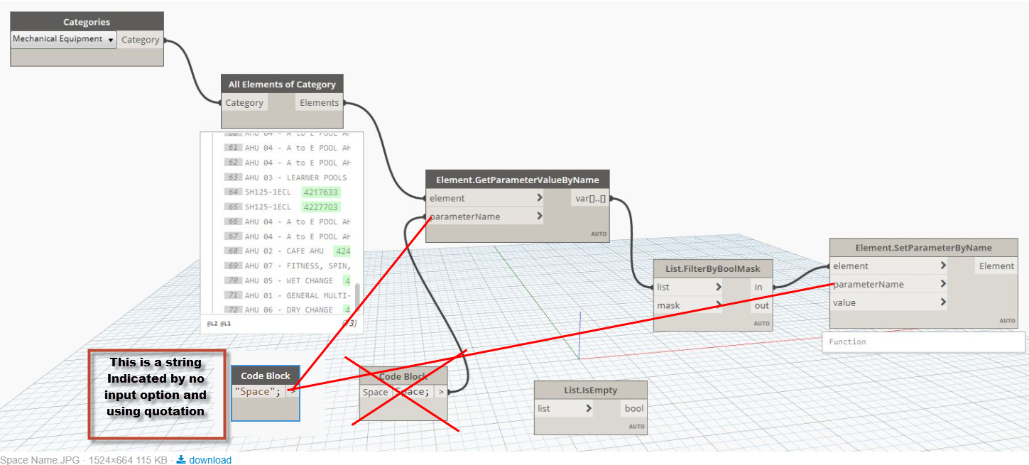

In addition to the post by @m.rijsmus you should use quotation marks for your parameterName. If you hover your mouse over the input you can read that it expects a “string” input.

I have now updated the graph as per your comments:

For the string space I have used “Space: Name” as this is what it is referred to in the Revit field, is this correct?
Does the string Externally Mounted also need to be in quotation marks?
Thanks again.
quotation marks if you use a code block
without if you use a string node

let me see the result after run please
Is the parameter called “Space: Name”? If you need help checking what the parameter is called, you can use the Parameters node. Insert it after Categories or All Elements of Category and look for the Space parameter, it should have the name in it.
Use what the string is before the “:”. So if it says Space : blah, use “Space” as the input for parameter name.
