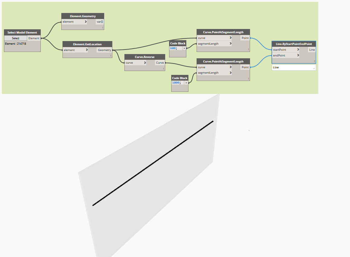

Can anyone help me how to change size of wall parallel. As shown in image outer main points are fixed originally, circled in green. Now when i try to reduce (or increase) the size points are moving only horizontally and not in angle (or parallel to wall), circled in red. Please suggest how to counter this problem.
you can use the node Curve.PointAtParameter:
Or use some Pythagoras to calculate the point you need
Hey Mate…
Thanks for that. It’s sorted out now. Cheers…!
