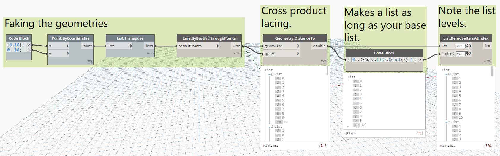

1: List.Combinations with length set to 2, then get the first and list items in the resulting array to feed into the Geometry.DistanceTo Node. As long as you feed it polygons without too many sides (makes for more possible combinations) this should be doable.
2: toy with the Lacing and List@Level settings of the Geometry.DistanceTo Node. My results have not been consistent across different Nodes and a great deal depends on your input List Rank, but a Cross-Product Lacing and @3, @2 List@Level settings, where both inputs recieve the same list, might work.
Geometry.DistanceTo with cross product lacing should work without too much fuss. Just be sure to drop the item at the index at the level of the list (would be 0) in all cases.

@Lucaly1994 Ideally you should try to avoid repeating nodes, as far as possible.

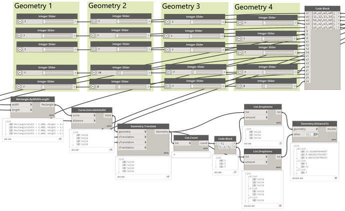

distance combinations.dyn (50.4 KB)
Thanks very much Vikram!
