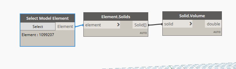

I have specific family in my project (Structural) and i would like to mesure is volume without use parameter inside for mesure.
It’s a complexe volume with blank extrusion , circle , etc…
The capture of the family below :
I
Does Revit automatically calculate the volume of extrusions made in families?
Is this data recoverable via Dynamo?
Is there any other way to calculate an extrusion volume inside a family?
Thanks in advance,
Guillaume
A French Guy
Hi there,
You could try to convert the family to Solid and calculate the solid volume
Cheers
Manel
Awesome Manel.
it takes into account the empty form Volume and separate for each volume.
Exactly what I was looking for !
Guillaume
