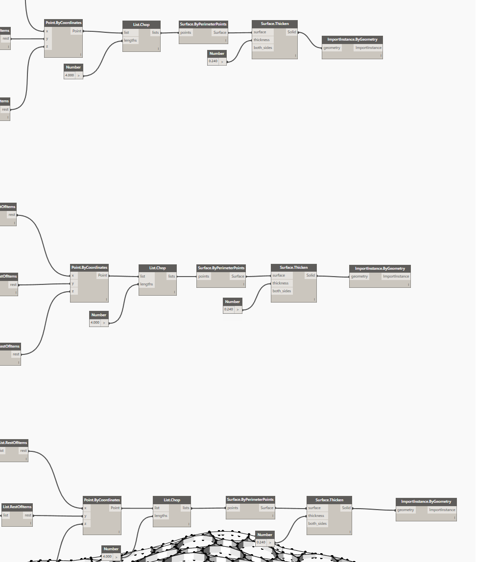

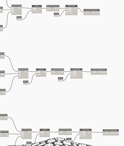

I created a building with dynamo, now i would import the model to revit.
In dynamo I created the beam with the polysurface and the floor with surface, so i would like to know if is possible to assign a revit family to each element (the beam and the floor) with dynamo.
