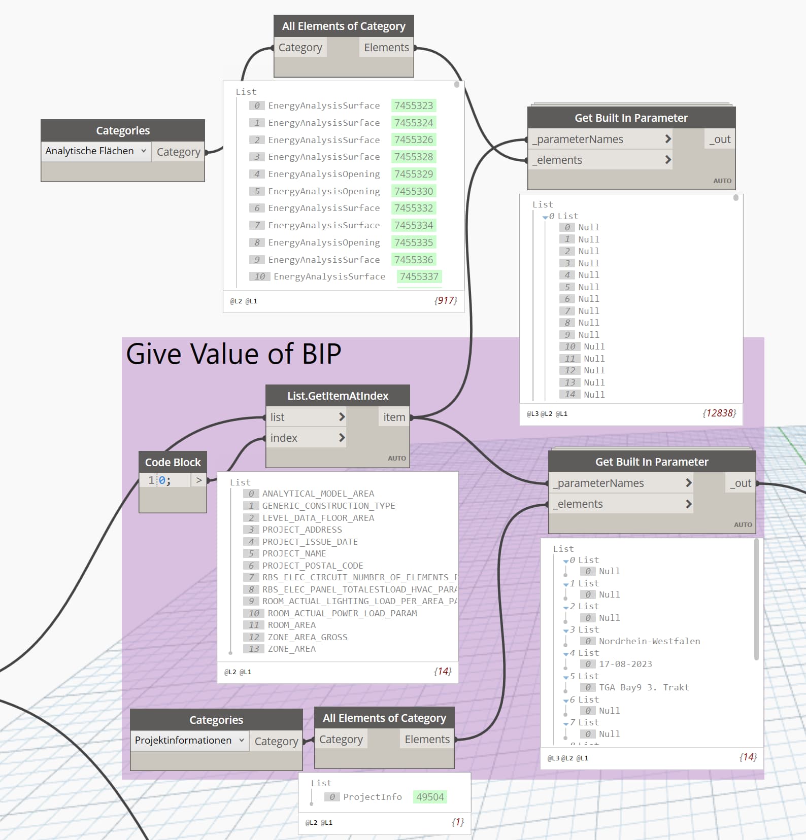

I have prepared an excel table in which I have collected built in parameters (BIP) that I need (import). I want to find out the values of the BIP. However, the problem is that I can not find the category and I do not know how to access these parameters and give a value in case. For example, how can I find out the sum of all rooms?
I am so happy for some help! I am completely new to Dynamo and I am trying hard to gather all information out of the forum but couldnt reach what I need…

what I originally wanted to find out is how to find out to extract all information what is marked yellow because I only get null (red marked). How I understand it now, it is not that easy as I imagined to extract the information from the BIP but I need to create my code for every single parameter. Is it right, would you agree with me?
(like here: Sum of Gross Area)

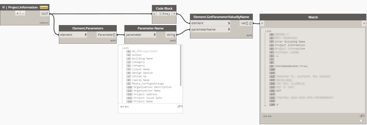

I would use the element.getparametervaluebyname as shown below.
You’ll need to trust me on this cause i am blurring for confidentiality.
What your script is doing is trying to get each of the 14 Built In Parameters against each element - if it returns a null the parameter is not present in the element
The Bip are basiclly what you would use if you script via C# and python. its not applicable to dynamo nodes. and even when working with them in script you would have to know from which categories to get them to actually be able to use them.
i am afraid that what you are asking for is kind of hard. if you know which categories you need the data from there is a lot of ways to move forward but without that information yah its not going to work.
