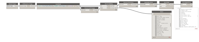

So what you’re in fact after is the parameters of each category in a list?
As the “BuiltInParameters” you are pulling is all the available parameters in the document?
It might be something like this you’re after:
Hi Jonathan,
First of all, thanks for your answer. I just test your dynamo, it’s interesting… but it doesn’t works in an empty model (a revit file, without nothing drawn: no walls, no columns, nothing).
The ouput list from “Document.ProjectParameterByCategory” is empty:
As far as we know, the “Document.BuiltInParameters” node of clockwork, lists the default parameters of the revit api, regardless of whether there is something drawn or not drawn, in the rvt file.

@EiPM_Xavier See if this OOTB approach works for you…
parameterNames.dyn (15.8 KB)
Very interesting approach Vikram, It’s good a script, thanks!
Although in “code block” shows a warning, the dyn file works (I run this dyn in an empty revit file)
