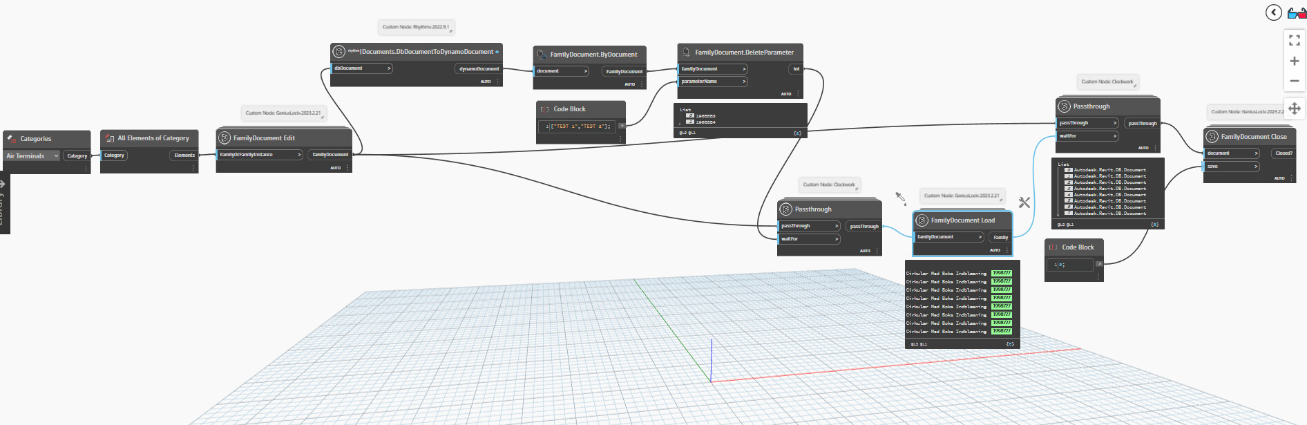

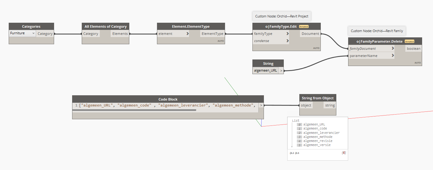

I’m attempting to batch remove a set of parameters from all families in a project. I’ve search for topics here but nothing I find works for me.
The below seems to remove the parameter I feed in by the string but its not doing the same for the code block. Thats one part I can’t figure out, what I’m also not sure of is how to load the family back into the project. By that I mean, when I run the script and open the family, parameters are removed (when using the string method), however the family in the project still has the parameter(s).

If I understand it right, I can only remove one parameter per transaction? Thats why the codeblock with further parameters wouldn’t remove anything?

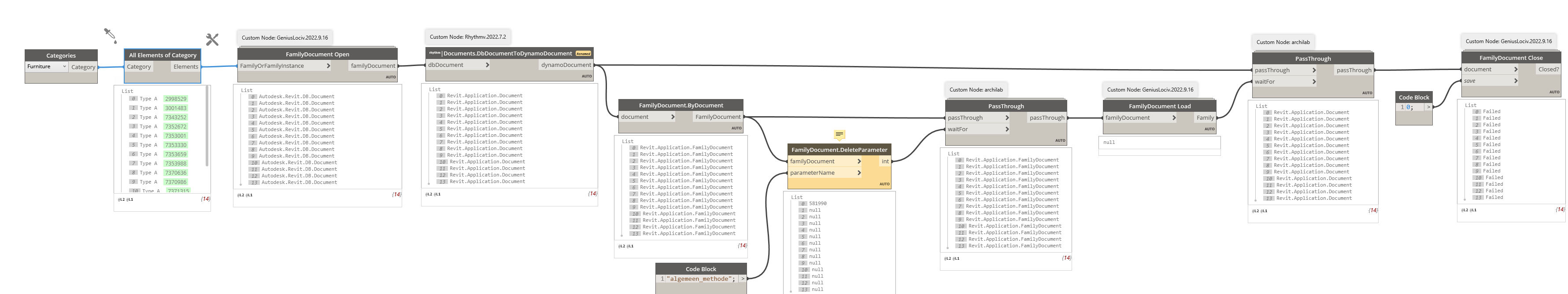

Hello @BJozi here is something there probably can help…but i would say if you have many files i would do it with birdtool or BVN…as is more stable i think :wink:
Revit_xBSAq04RUy
Bird tools MultiPlayer, manually running on each family, or utilizing Python to open each document and perform the actions before saving and closing.
Hi Sovitek, I couldn’t quite follow your gif (couldn’t pause it). Is the below correct/the same as what you had?
I do have a warning on the familydocument.deleteparameter node:
Warning: FamilyDocument.DeleteParameter operation failed.
A sub-transaction can only be active inside an open Transaction.
When I open the family the parameter is gone but change is not being loaded into the project.

Not really sure…try set your lacing to shortest in "family document delete…
The benefit with Bird Tools Multiplayer is that you write the graph to work on one family, and it runs said graph on N families - meaning you don’t have to worry about background opening documents anymore.
Yes thats best in my opinion :wink:
