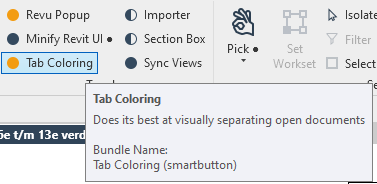

pyRevit has a smartbutton builtin. It’s a toggle button to start/stop a script.
color=orange: re-run a script continuesly in the background.
color=black: stops the script
How can reproduce/create this for my created scripts?
