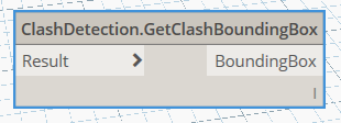

I was trying to run clash test and generate views for my clashes using Dynamo.
For that I was looking for some custom node or packages.
If you could help, please share your inputs/suggestions.
@12rahulkadam, you could try the DynaWorks package, if you use Navisworks to run clash tests:
The other way is to set Revit Section Box by Dynamo BoundingBox:
http://dynamobim.org/forums/topic/section-box-by-bounding-box/
Thanks @zhukoven, I will definitely give dynaworks a try.
But are there other ways, if I am not using Navisworks output.(other than section box)2
