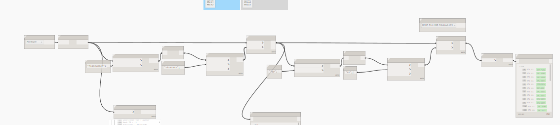

Hello Dynos,
I have a little challange:
I just want change some titleblocks to a other type of titleblocks. Manualy it is easy, but the problem is i have more than 100.
My script works well until to change them. So i can filter my titleblocks but not change them.
How does it work?
I am glad about any help
KR
AndreasTitleBlock.dyn (15.2 KB)
Something like this?
What Jan shows work, but isn´t it possible to select tittle block in project, right click, select all instances in project and change all of them at the same time?
Yes thats the fasest way, there is no chaos regarding positioning
