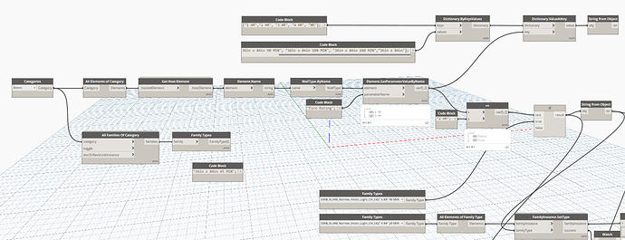

What if I want to do exactly like you showed, but I want to use a dictionary…because I don’t want to specify one wall type and swap it only I want to swap multiples at a time… image below is me brainstorming…
