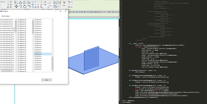

It turned out to make a drop-down list with two elements that, when selected in the table, are isolated and scaled in the center of the screen. But now, with any revit command or escape key, the view is restored to the original without any isolated elements.
As far as I understand - the reason is the absence of a transaction - Revit does not execute the isolation of elements as a command. Is it possible to somehow correctly register a transaction here for executing commands with Revit?

Is it even possible to inject a transaction into the body of a function in a class? It doesn’t work and gives me an error
no,
a workaround is to implement an IExternalEventHandler Interface
some examples
Otherwise, without transaction, instead of isolating the element, you can zoom in on it with uidoc.ShowElements()
Thanks for the links! I will study, I think that I need the first scenario. I just need to figure it out. Might be able to come up with something.
