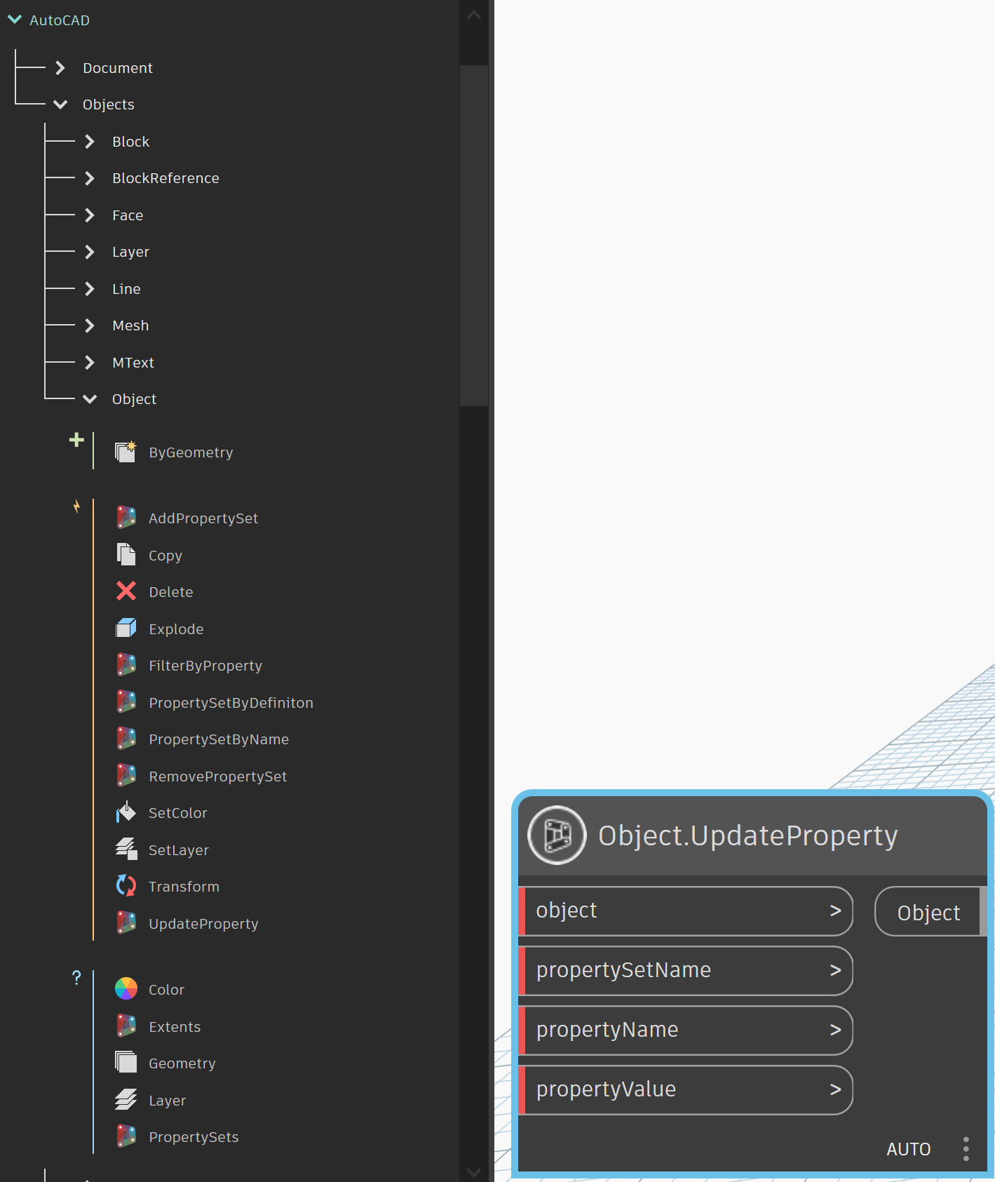

Hi @nithin.johnR6TY8, it is possible. Don’t forget that you can use also Civil3DToolkit nodes. But node to update property you can find here

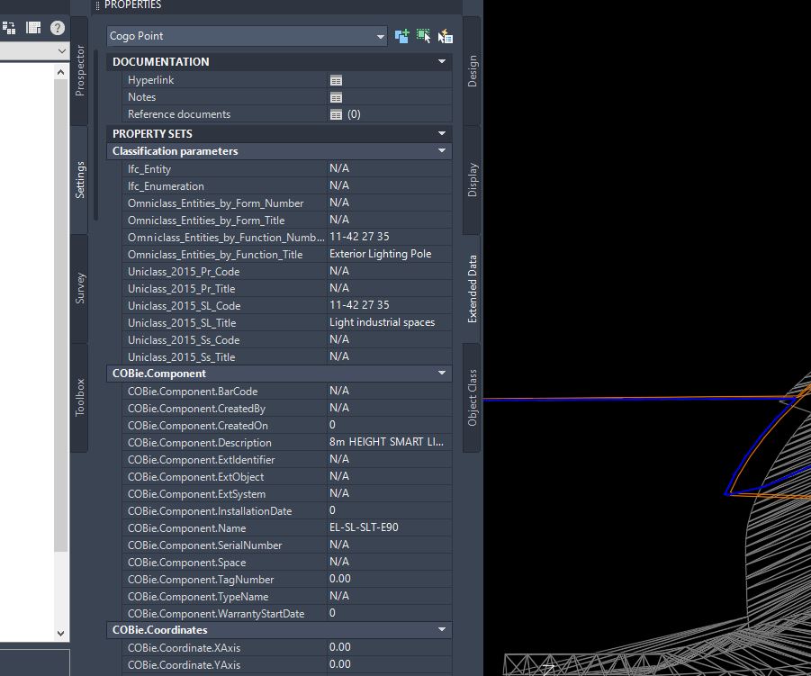

Boss, Im trying to do fill my extended data (eg:cobie, wildcard parameters). now im filling manually one by one. i shared screen shot for you reference.

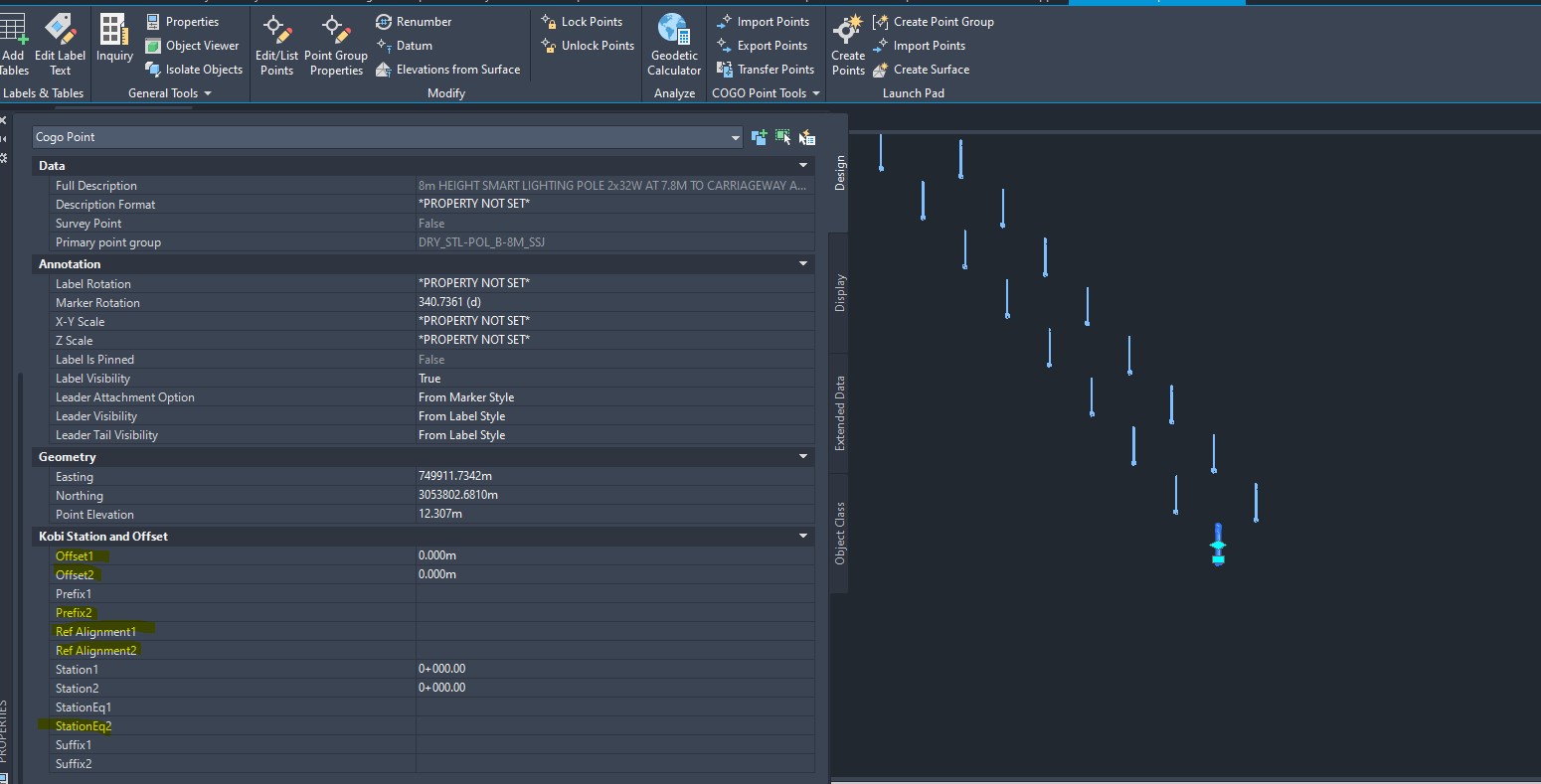

Hi, there is no alignment, its street smart light pole, i fixed pole as a cogo point, using block, now i want to update my extended data (cobie parameters), you can see that in property (below design & display). currently im inputing value as one by one, dynamo can reduce the work load , please see the screen shot

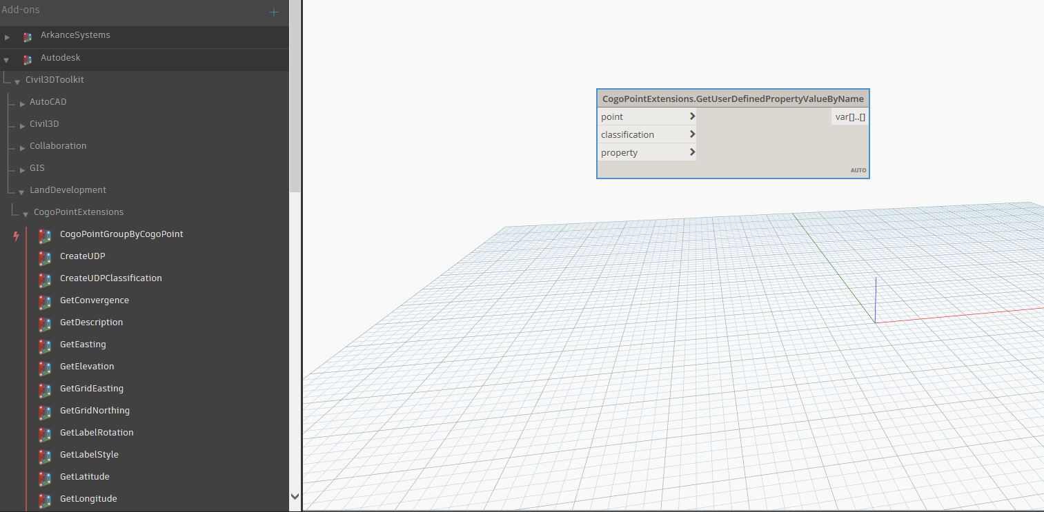

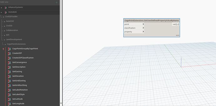

Maybe this helps you
In my opinion this can’t help. The question was about extended data, property sets and property values update. This COGO point user defined property is only for COGO point when you need import, export or annotate COGO point with this properties.
you are right

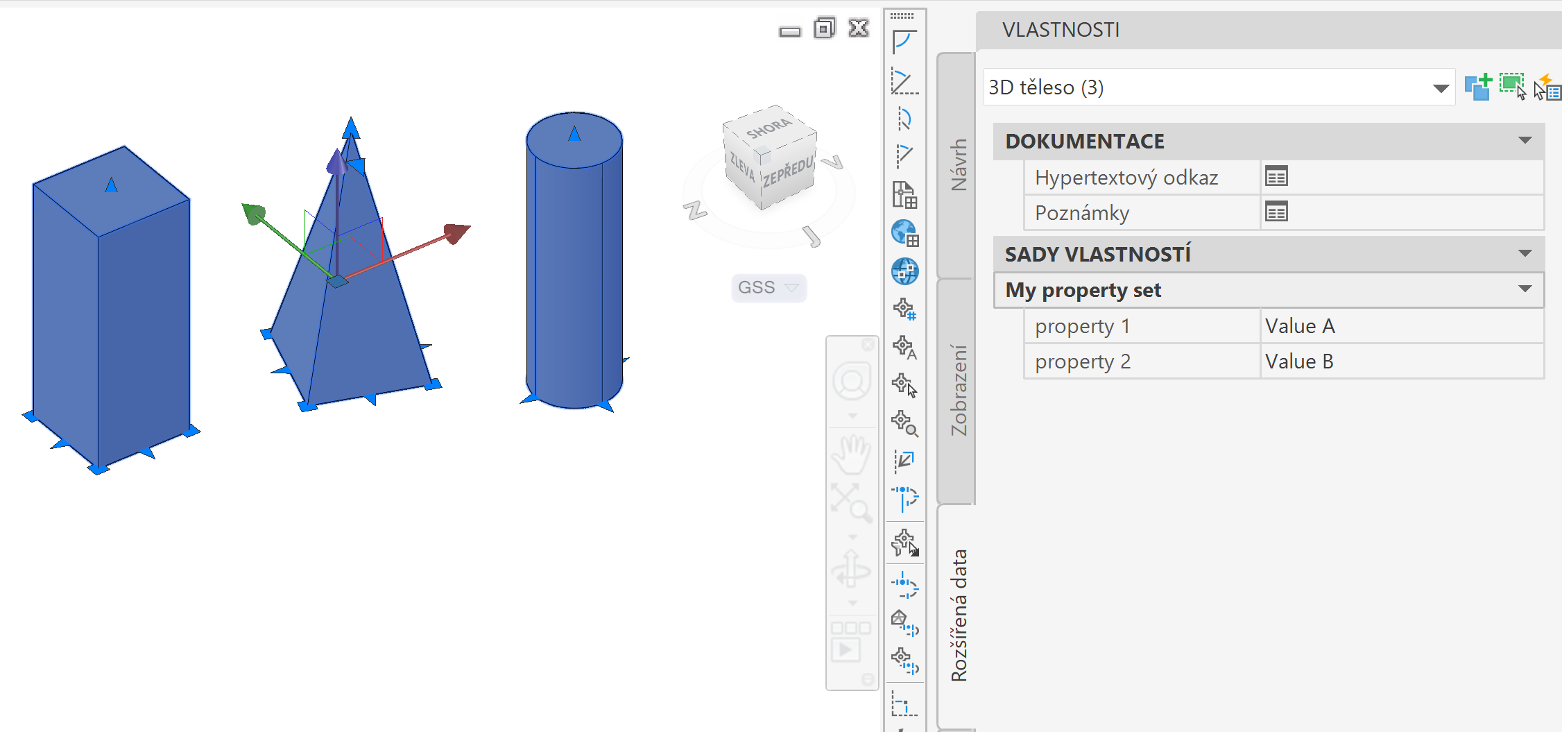

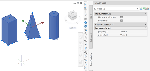

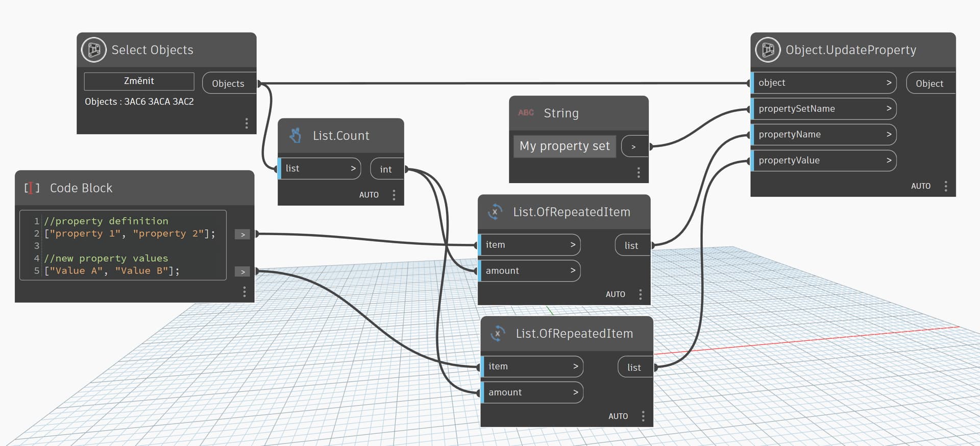

@nithin.johnR6TY8
see this
