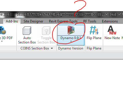

Hello I downloaded and reinstalled dynamo 1.3 to the default folder by my revit cant see it and it seems to not be able to see my dynamo 1.2.1 any more either. Anybody know what happened, and how I change where revit is looking for dynamo? And, no, its not in the dynamo drop down thats just dynamo 0.7.1. Thanks!

Dynamo 1.3 will not work for Revit 2015. It will work for Revit 2016 and higher version. Your Welcome!
Ok, well then how do I get revit to see that I have dynamo 1.2.1 installed then? I just doesnt “see” it anymore. :frowning: Thanks!
Uninstall Complete Dynamo 1.3 and then re-install 1.2.1
Thanks Kulkul, that works!
