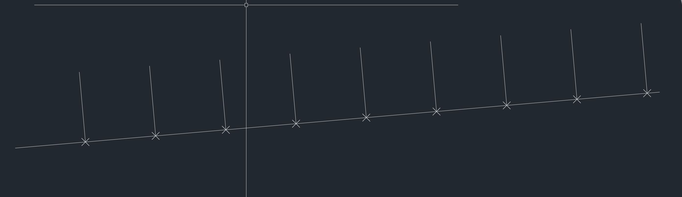

I need to create line at 60 ft interval along a polyline.
line need to be at 90 degrees to the polyline.
I have tried various rotate nodes.
to no avail.

Perhaps those nodes would help: Curve.CoordinateSystemAtParameter
Geometry.Transform

That image is the end goal
But I did it in civil 3d.
If you run the attached dyn you will see the lines at 60 ft intervals are in the direction of the polyline.
I need the vector to be rotated

Why it doesn’t work for you? I just tried @Ge0rges method it does work for me :
working_.dyn (49.3 KB)

I was getting lines that were not 90 degrees from polyline
Ge0rges
This is the solution

it sure does work
