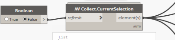

I finally Found the Springs nodes under Library → Springs→ Revit→ Selection→Current Selection→Current Selection. I will try it out . Thanks everyone or helpful reply.

Thanks. That helps to explain What the refresh means. I tried both True and False.Most ofthe time it is better to use true. Thanks

The problem with the Collect.CurrentSelection is the need to toggle the true and false to refresh and get a latest elements. Is there an automated way to do this ? Seems not that elegant. Thanks
Force execution in tuneup, or use Dynamo Player.

The tuneup view extension has a method to re-execute all nodes. Newer builds have it incorporated by default in the extensions menu. And older builds can install it from the package manager (make sure you get the right build for your Dynamo release).
