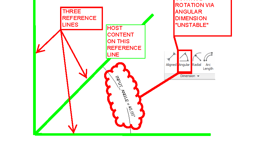

I know you wanted to stay away from rotational parameters inside the family, but I’ve found this one quite sturdy:
