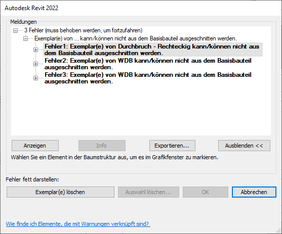

@jw.vanasselt ,
i had a similar issue here
[2022-07-12_15h40_21]
[2022-07-12_15h40_45]
How can i ignore this error.
My script just sets Workset to the correct Element…
It stopps at this Error(Warning)… how can i “ignore” it?
finaly what is a circle-reference? how do i (accidently) generate it?

problem is the error happend in Revit not in Dynamo
@Draxl_Andreas , then you have to go a step back. Why does Revit give this error? Try to find that out and pass those elements.
Or do you know before which element doesnt work? Than you can try to use the id of that element and pass them in an if statement
