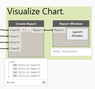

Everything runs ok without errors but I got the final node “Report Window” as Empty Dictionary as below
Are there anyone hit the same problem as me or any advise would be appreciated ? I attached my dynamo file for your reference. Thank you.

I don’t think that that last window node actually outputs anything so it will always say Empty Dictionary. Its output is what shows up in the window when you launch it. Just press the button.
when I press the button, there is nothing but empty window

Well that’s an old post and I am sure the workflow that was described in there is not for Dynamo 2.0. I wrote that post. Archi-lab.net is my blog. :slight_smile: Anyways, that won’t work with Dynamo 2.0 so you will better start re-doing that from scratch using Dynamo 2.0 and then report what doesn’t work. At this moment what you are asking for is for me to go back and update my post from two years ago. That’s a tough ask. I also got posts in there from 4 years ago, that I have no plans to update. You see my point?
