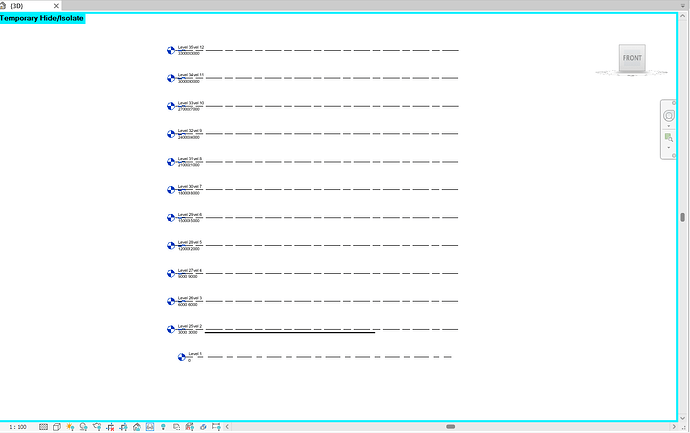

How can I make the script copy the ceiling for several levels at once, and when I add a level, for example, can I edit the script and add a level, and it will add a copy of the ceiling to it?

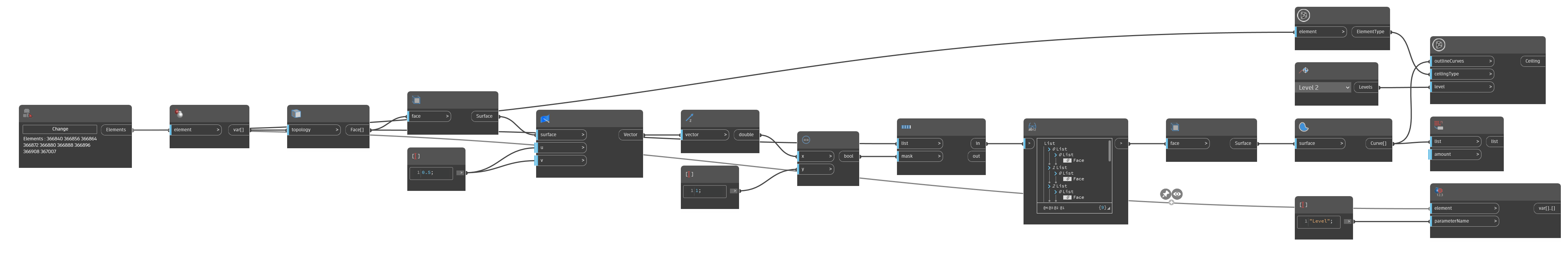

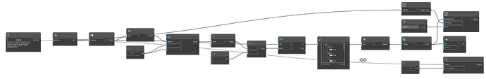

Hello @mohamed.salah.mostaf and welcome to the forum :wink: yeah it should be possible…but could you zoom your image so we can see whats goin on…
probably something here
Revit_G4u2EwqYdv

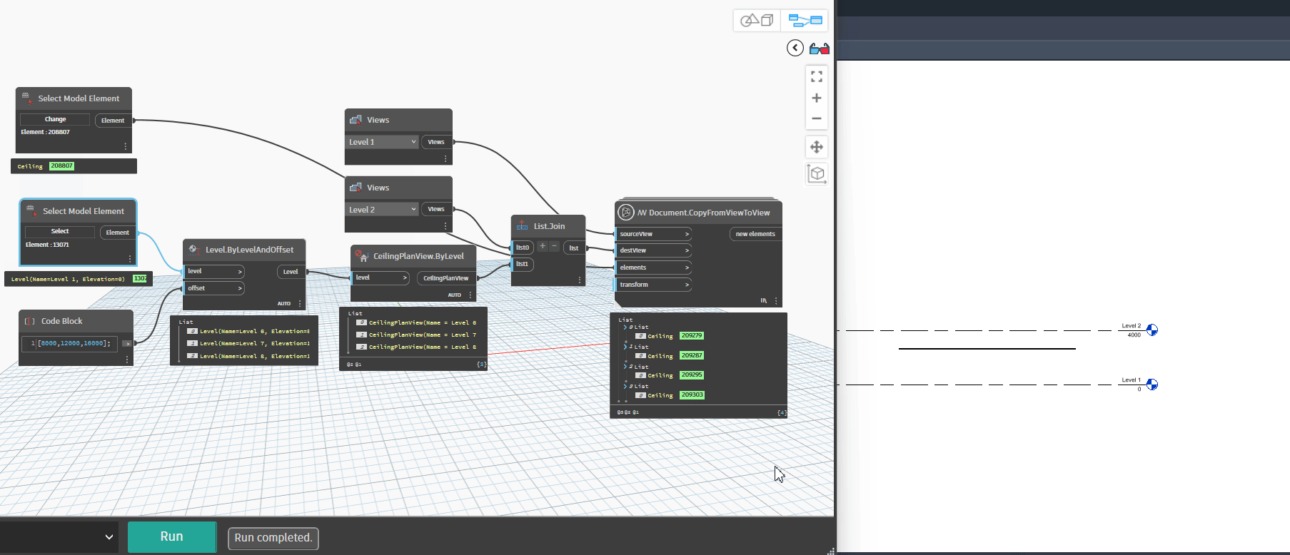

when i run that script it makes a copy from levels not from ceiling what is the proplem ??
i made the lacing for the last node to longest

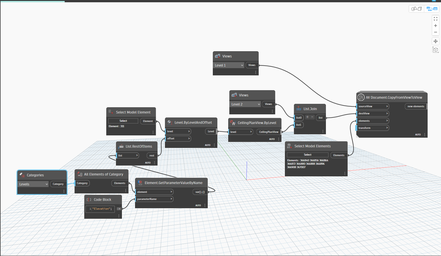

If i need to make the input of offset to run automatically when i add a new level
Hi @mohamed.salah.mostaf im not sure i fully understand, do you want run the graph in automatic, if so not sure havent tried…but seems you select a lot of ceilings,however try with one and then scale up, guees it about some lacing etc..if you want multiple…be sure you have ironpython package 2.7 version 2.5 installed as well if in 23-24 for spring copy node
