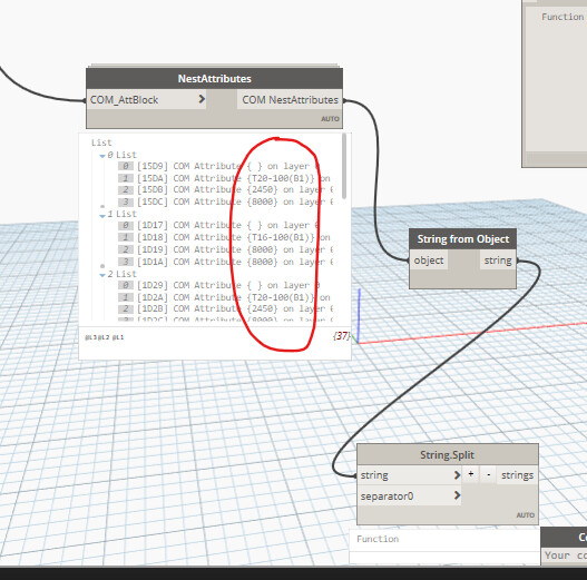

How can i get the string inside the flower bracet { } without splitting the group
WITHOUT SPLITING THE GROUP

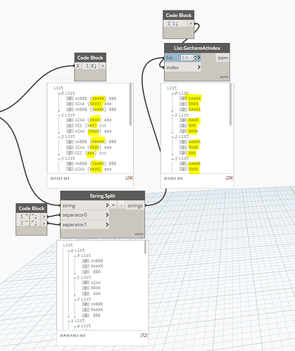

Hi @vikas.kpoojary <
Don’t quite understand the requirement would this work?
Thankyou its working fine
