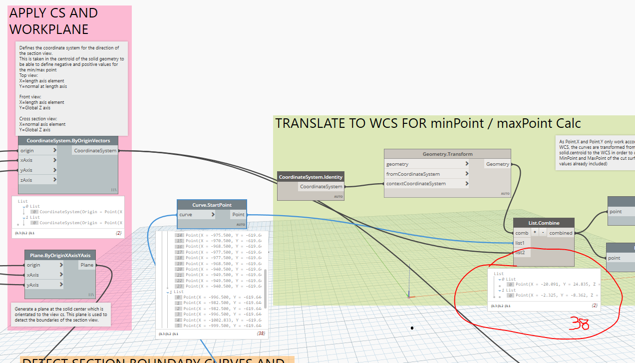

I would expect to have a list structure that matches exactly that of my curve start point list (2 total lists with 38 individual entries like in the screen shot below), like I get when I do this on a single part. I was thinking that maybe controlling the levels on this node would solve this problem, but list.combine node does not allow for level control? Never experienced this before on a node; I have not used list.combine at all before.

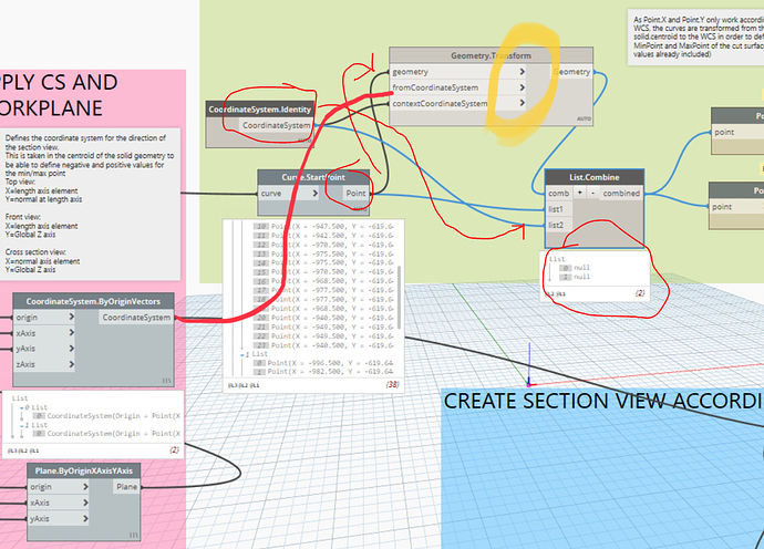

So I have tried the suggestions you provided to me, but with no luck.
First suggestion:
Trying switching inputs may be connect points to Geometry input and coordinate system to list2
Attached is screenshot, it yields a null result now.

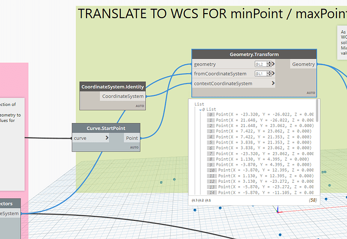

In the newer Dynamo versions, the result can be achieved using levels and using the nodes to calculate rather than building a function. Start with this, and adjust the list levels acordingly:
Thanks @jacob.small, that did the trick.
