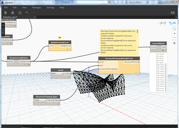

<br class=“Apple-interchange-newline” />Hi, how are you Here again a proble I hope someone can guide me how to fix As I can insert a structuralframing.beambycurve on a curve that is not planar or can convert planar curve .
A quick crude work around…
You could also consider using the node Curve.ApproximateWithArcAndLineSegments node
Hey @Vikram_Subbaiah ,
Do we already have any workaround to model StructuralFraming.BeamByCurve elements with non planar curves? I´ve been doing some investigation and could not find anything. You know most of infrastructure projects have these non-planar curves following the slope of the road in profiles view + the curvature in plan view.
