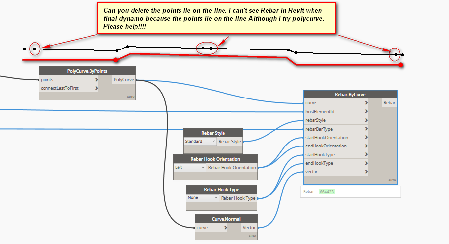

I would like to create the rebar beam in Revit with dynamo, but i can’t create it because the points lie in the line. I try to use polycuver by point but not good. Please help me to delete it. Thank you so much!!

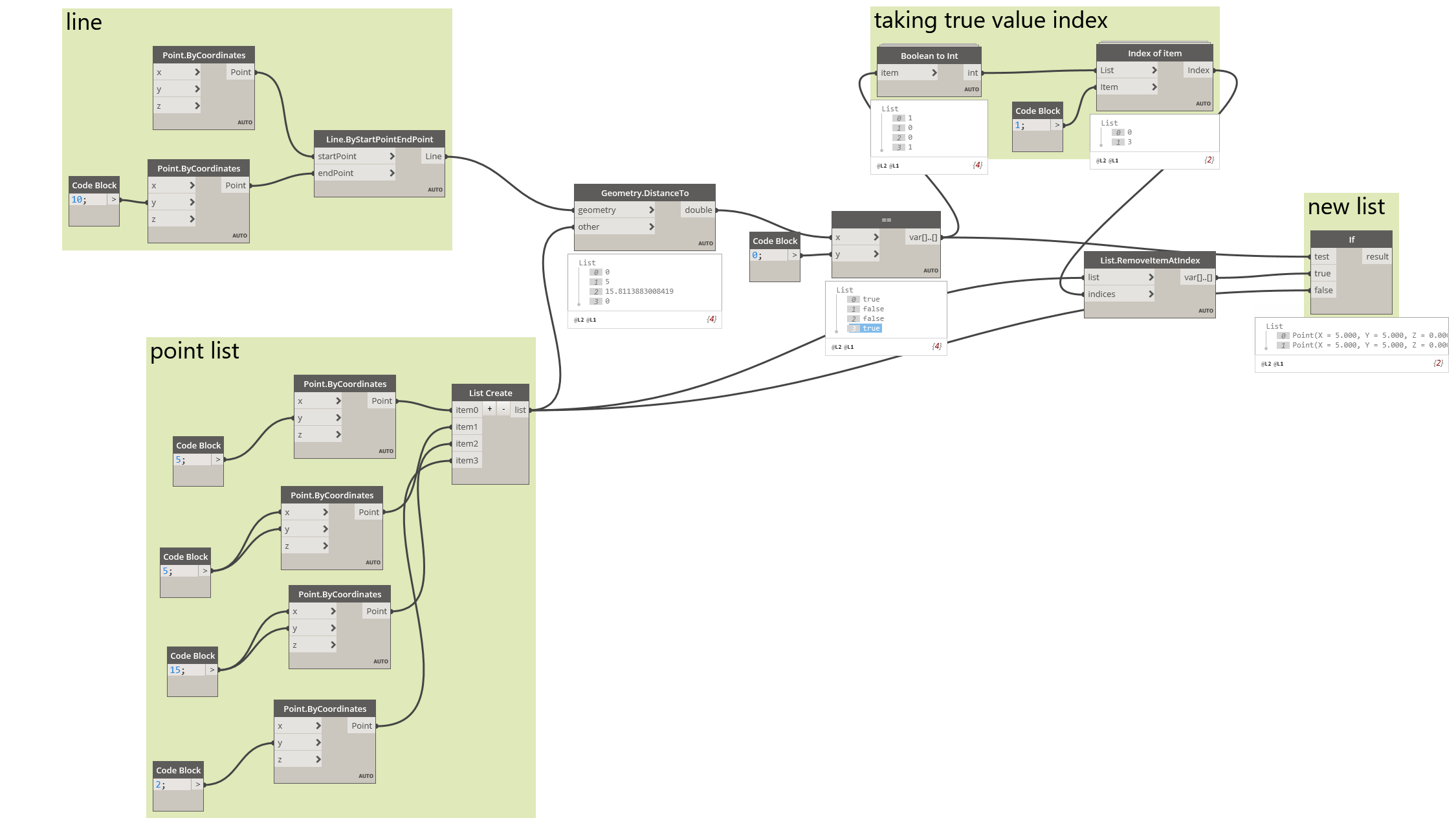

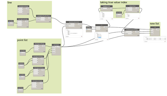

i have calculated distance from the line and deleted using IF node.
You have multiple lines. extend this
Thank You sir! But can you help me to do like it with poly line?

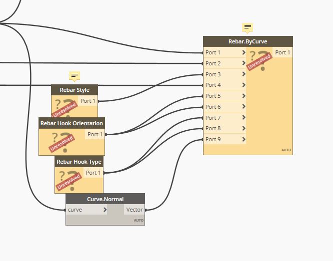

Which package is this? and your dynamo version
Send with a little more complex shape. or do you have only this Linear shaped?
Hi sir! I am using dynamo 2.0.2 and pagke BIM 4 structures + Dynamo for rebar 2.0.2.

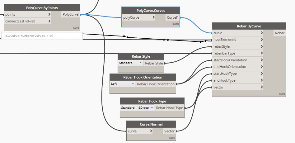

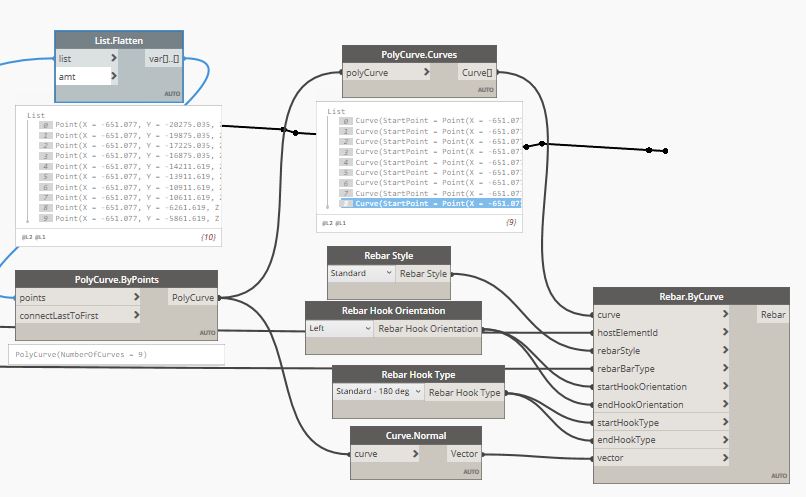

I just try it, but it not ok. I would like to make 1 rebar by polyline. Not single rebar. Please help again?
probably not possible to create one single rebar tracing that polyline.
anyone can comment on this if it is possible to do or not.
