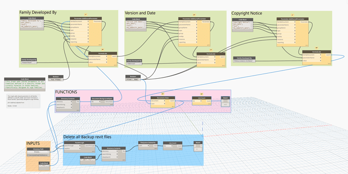

This is a graph i use to watermark our in-house developed families. It broke for some reason. any help would be appreciated.

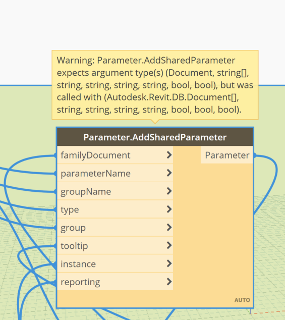

Looks like you are using Orchid by @erfajo and support for that package is usually best through his GitHub, but a couple questions may be did you update your version of the graph like 1.3.3 to 2.0.1 or did you update any other packages? What are the error messages above the failing nodes?
The error explains that you’re using the incorrect object types for the node. You’re using the wrong document type and the tooltip input should be a string.
