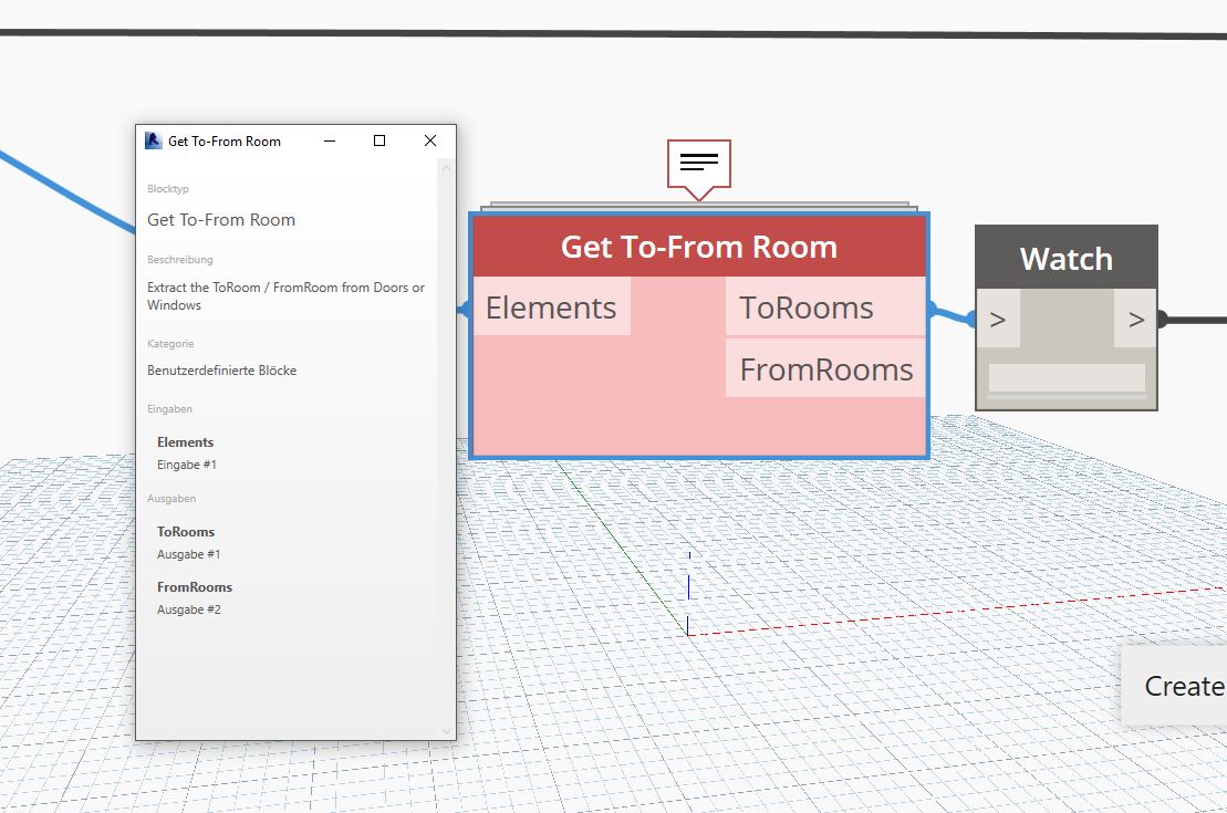

Hi Dynamoers,
obviously we can group nodes and name them, put notes.
but to properly document each graph and understand what node is used, in which version,it would be appreciable to add a text like the picture below to tell from the start where from, what, which version.
Good idea. Even if this was added as a pop up display as you hover over a node title? I have just been grouping with a header, writing a description note for the script or pointing all users to the same network path for packages to avoid any issues of “node not found”
The note is the typical method for documenting this at my office as well. I have considered adding version numbers to this due to renaming issues as packages grow and change, but have held off because it felt redundant.
Out of curiosity, how would a graph read the correct version of a node in the illustrated example? If I create a graph and have archilab 1.12.10 and @Ewan_Opie opens it and has 1.13.2 do we both see 1.12.10 as I wrote it with that or does he see 1.13.2?
You guys know that right clicking and getting the properties will indicate the data about the package including the sub heading, right?
