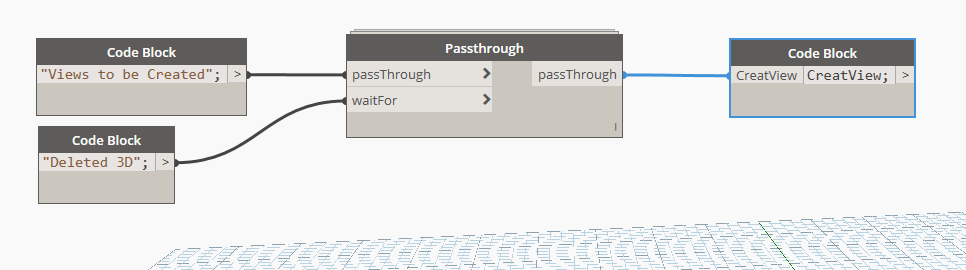

I tried but it didn’t work. As shown in the below screenshot, It created the previous 3D views but didn’t create new 3D views.
Very simple but should look like this.
Thanks. I tried again. But it doesn’t work.
Now my views (two 3D views), which were created from the last run, are deleted, but the new 3D views are not created after that. :frowning:
A Passthrough or Wait node simply says “don’t do anything that comes after this node until these two variables have values” - the two variables being passThrough and waitFor. So you could delete the current views and get the view names of the new views you’re going to create, but since you don’t want to create the new views until after the previous views are deleted you would want the new view creation to come after Passthrough.
Your waitFor input would likely be the new view names to be created. Those values wouldn’t get “passed through” the node until after the previous views have been deleted. Then you could continue to create new views with the new names.
