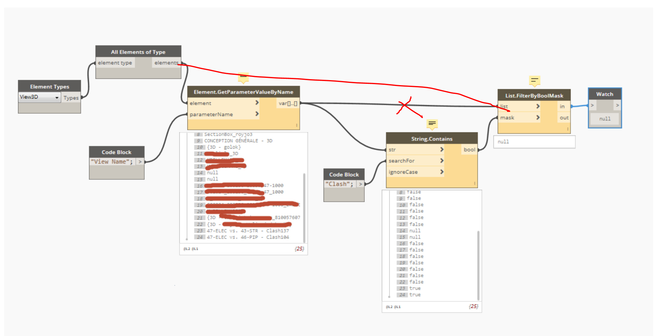

I worked on a script to create new 3D views based on each specified clash in Revit model (As shown in the first attached pic). I want to extend my script to automatically delete these new 3D views, which were created in the last run, before creating new 3D views based on new clashes.
Created%203D%20views%20by%20the%20script
To delete my views, I tried to get all my 3D view names from the model, and filter it to use “Delete Elements” node to delete them, but it did not work unfortunately (Please see the attached pic).
Can anybody help me? How can I give sequence to our modules in Dynamo? In the same script I have a module to create new 3D views after each run. How can I delete these two 3D views first before creating new ones?

Hi @Mojtaba.vlj, you are trying to get a “True” with anything that matches “Clash”. You need to use a String.Contains “Clash” and then get the true/false from that to your List.FilterByBoolMask :slight_smile:
Hi,yes. I want to delete views that has “Clash” in their name. Could you please send me a very simple example? Thanks

Between Element.GetParam node and String Contains node, you need a “String From Object” node to convert the value to String. :slight_smile:
@CVestesen
Do you think those values are not strings already?
You’re right, didn’t notice. Just assumed they were not :-).

It worked. But when I wanted to delete those views by “Elements.Delete” node from archilab, it gave me an error. I also tried it with “Tool.Eraser” node from SteamNodes, it did’nt give me any error but my views were not deleted.
Try use a Flatten between Mask and Elements.Delete.
@Mojtaba.vlj
Null values are the culprit here i think.
So the selection of 3D views is not working.
A View must have a name
Just tried it. Removing the nulls will do it :slight_smile:
I tried with Flatten between Mask and Elements.Delete. but it still doesn’t work.
Thanks @Marcel_Rijsmus for your response. But when I check my 3D Views, I see all my views have a name. How can I remove nulls from the list?
didn’t see at first
There is a node called ‘IsNull’ which returns a true/false. Use a Mask with that.
I tried again and finally it worked. Now my views could be deleted. Is null usual as shown in the following pic?
