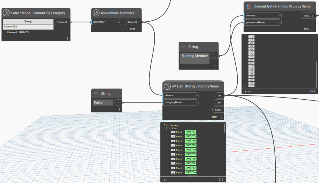

Hey,
I’m working on some assemblies that have parts for insulations and cladding of the wooden prefabricated wall elements. I need to filter the part under the assembly by a certain parameter and then set another parameter value. I tried some ways but they didn’t work. Can you help me figure out a good solution?

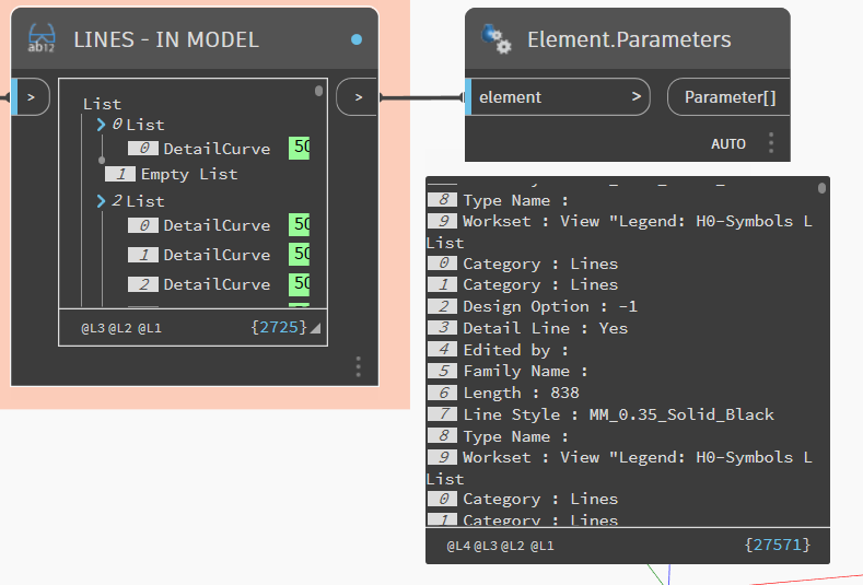

It may verywell be a “Valid Parameter” but you may need to aquire it through other means.
Such as the above example, a detail curve has a “Family Name” parameter but it is blank, Because thats not how you would get the name of the Detail Curve
To get the name of a detail curve with python you;
1.Collect all linesStyles LineCollect = FilteredElementCollector(doc).OfCategory(BuiltInCategory.OST_Lines).ToElements()
for Cats in LineSub:
LineSubName = LineStyle.Name
LineStyleName.append(LineSubName)
Or maybe filter here
4.Output the Names
So you can see, that the path you want might not always be as direct as you would expect it even if you can see the element in Dynamo.
