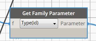

Element.Parameters does not get all of the shared and family parameters. “Get Family Parameter” gets everything I want, but I can only select one at a time. Any thoughts? Thanks in advanced.

I am still noticing some parameters that do not come up using the above methods (Specifically, instance yes/no parameters are not showing). It looks like “Get Family Parameter” gets them all. Any Idea on how to create a list from that node?

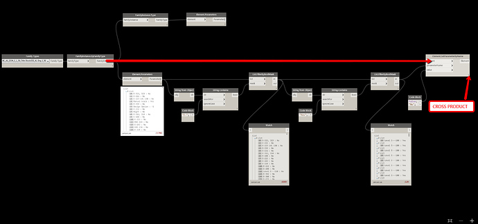

I further developed your nodes to see if it could solve my problem and I’m almost finished. I just need some help getting over the last hurtle. I’m trying to uncheck specific parameters (Yes/No) )in a title block family that is used in a large number of sheets. I’ve manage to sort out the ones that are checked so that the can be unchecked and the last thing to do is Element.SetParameterByName but I can’t get the element correct.
Grateful for any comments. Am I going about this the wrong way?
@Lukas_Nowikowski
Set the lacing of the Element.SetParameterByName node to cross product and connect your elements.
Also Flatten your list of parameters.

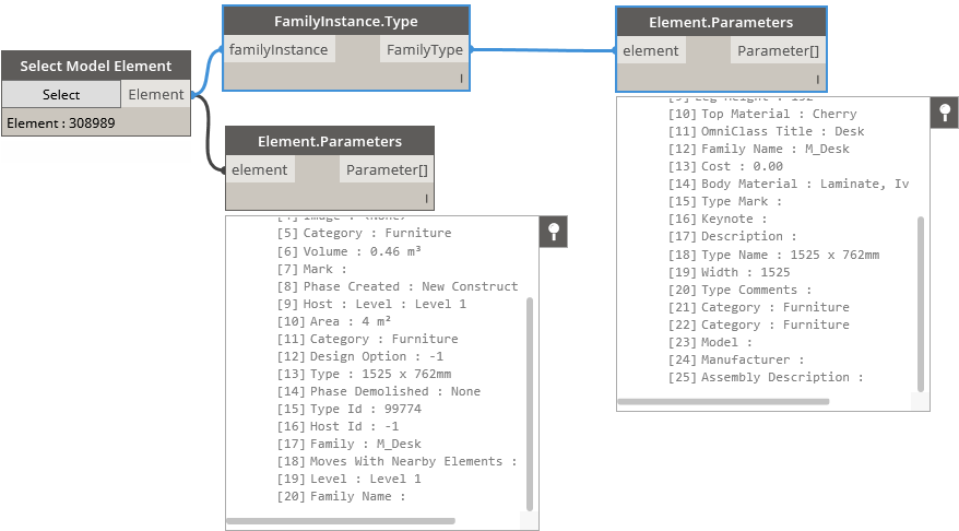

Hello, It seems like the parameters that you get from “Element.Parameters” are only the parameters from the object (red in my image), you still didn’t get the parameters of the Type(blue in my image)?
I am trying to get the parameter of the Type, so that I can do parametric modeling based on these parameters. Is it possible?
Get the family type via the elementtype node which was described above then you get the parameters from this to get the type parameters.
Therefore you will have two get parameter nodes, one from the instances and one from the family types.
super ! Crazy Good. It works quite well with the Plugin Rhythm
