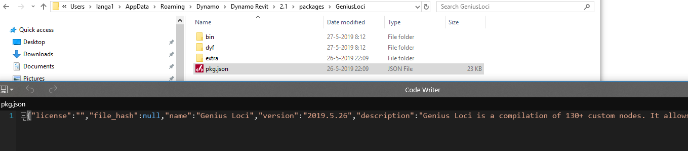

i got 2019.5.26, but don’t see the merge pdf node or any integration

You can check that the GeniusLoci.dll file is not blocked (in right-click > properties) in :
C:\Users%USERNAME%\AppData\Roaming\Dynamo\Dynamo Revit\2.1\packages\Genius Loci\bin
Strange thing is that i do now have the same list…only not the merge…
the node…is resolved… but i can’t find him in the list.
