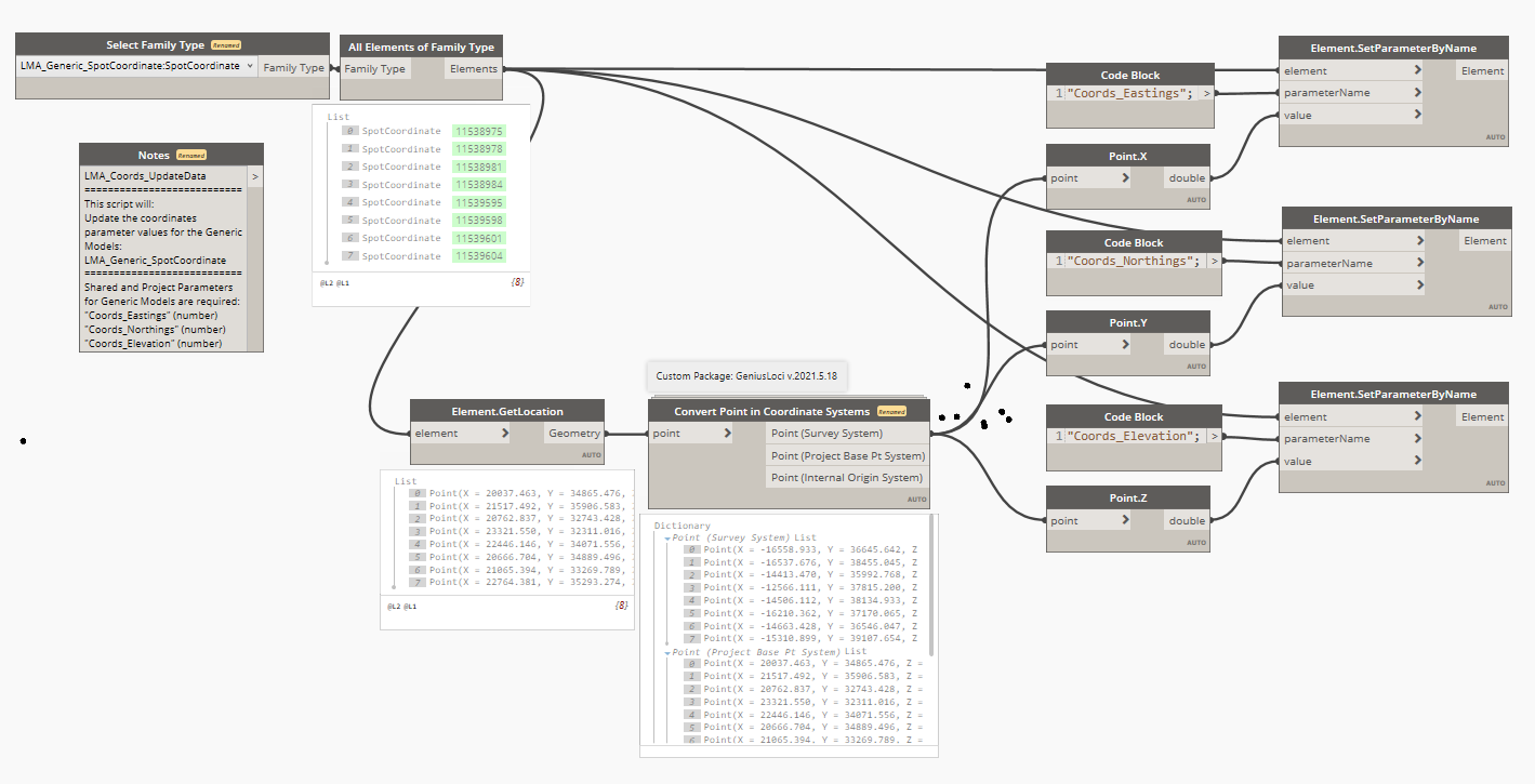

Hi… I’m having trouble getting a graph to work across the office. It works on my PC, but fails on all others. Same Revit and Dynamo versions, same package library (local to each PC).
Specifically it’s the Genius Loci Convert Point in Coordinate Systems (v.2021.5.18) which should return values as per the image below, but on my colleague’s PC’s returns Nulls.
Any clues as to what the problem is are most welcome

Hi @scott.tomlinson,
Double check the Genius Loci package version. There were change in the Revit API regarding document coordinates.
You can also update the Genius Loci package to the latest version.
Hi @Alban_de_Chasteigner … thanks for your reply. The graph worked across the office until we started to use it in R2022. I updated the package libraries with the one that was released for R2022, which I though might fix things (it didn’t). I will update the office package libraries to the latest version as you suggest. Fingers crossed.
Awesome… thanks very much @Alban_de_Chasteigner . All running smoothly again
