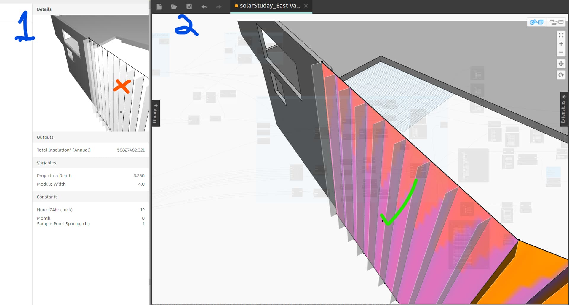

Generative Design Outcome thumbnail missing graphical information
No issues with GD outcome data other than missing graphical information in the thumbnail.
There are (2) geometries which are ultimately displayed by GeometryColor.BySurfaceColor in the graph.
Both preview well in the Dynamo environment, but the solar analysis does not display in the GD Outcomes. The other elements show correctly in the Outcome thumbnails. I’ve recreated the GeometryColor.BySurfaceColor (that represents the relative insolation values) node twice to make sure there was not some unknown glitch. Data.Remember is not available for GeometryColor.
Thoughts?

@jacob.small , any troubleshooting recommendations or research points I can review to help?
Sorry - update to the latest Revit 2023. You’re missing a year or so worth of updates including a GD update or two.

In any case, do you have geometry preview in Generative Design now?
The package appears to be working. I am able to Create Study and Explore Outcomes, but still missing graphics…

As the content still not displaying we move onto the next troubleshooting step. I’ll try some troubleshooting on my end. Can you post your graph as it currently stands?
