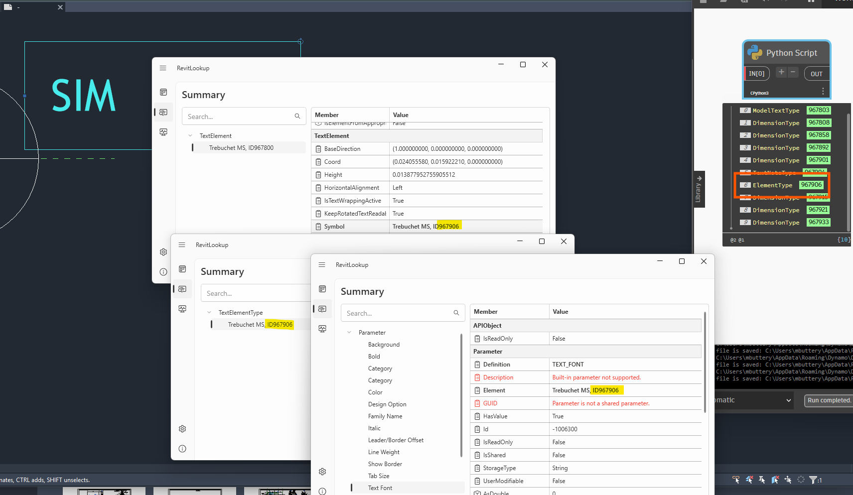

Use BuiltInParameter.TEXT_FONT and a filtered element collector to scrape all the types that have a ‘Text Font’ parameter, go from there
Edit: Also RAMP_ATTR_TEXT_FONT, STAIRS_ATTR_TEXT_FONT, TEXT_STYLE_FONT and TITLE_FONT if you are being thorough
Edit2: This collects anything with the parameter and will capture model text, text notes and labels in families
clr.AddReference("RevitAPI")
from Autodesk.Revit.DB import BuiltInParameter, ElementId, ElementParameterFilter, FilteredElementCollector, ParameterFilterRuleFactory
bic = BuiltInParameter.TEXT_FONT
pfrp = ParameterFilterRuleFactory.CreateHasValueParameterRule(ElementId(bic))
epf = ElementParameterFilter(pfrp)
OUT = FilteredElementCollector(doc).WherePasses(epf).ToElements()

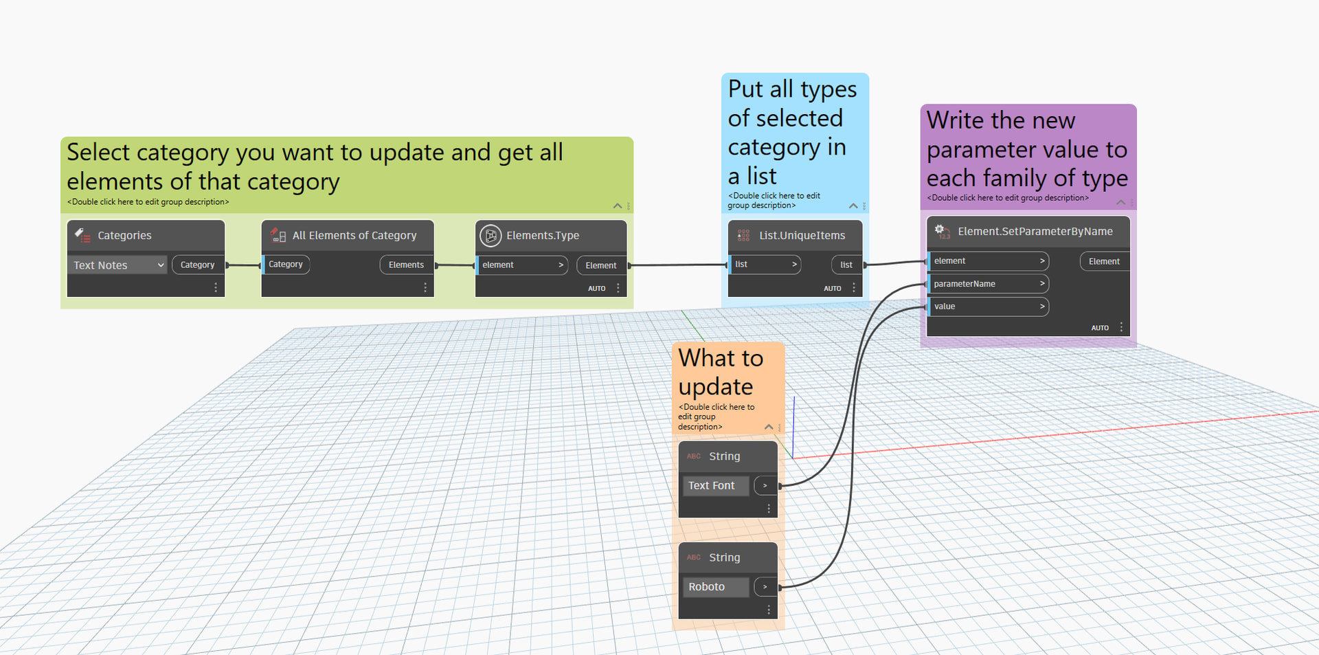

So I have a simple Dynamo script that changes the Text Font parameter to Roboto for Dimensions and Text Notes. Pretty easy.
Labels are the tough one. I had hoped I could just change the category to Generic Annotations or Title Blocks (as that is what category lable seem to be by default) but it doesn’t work so far. There is no error or warnings in Dynamo so thats good, but none of the Labels change Fonts.
I will keep trying and update the post when/if I find the solution.
Thanks to everyone.
I will post my Dynamo scripts here for all future visitors to see.
Thanks to Mike Buttery above for the python code. Works like a charm.
I should mention that I think this is good for a small project or family file. For my project template I actually did categories one at a time using this Dynamo script:
