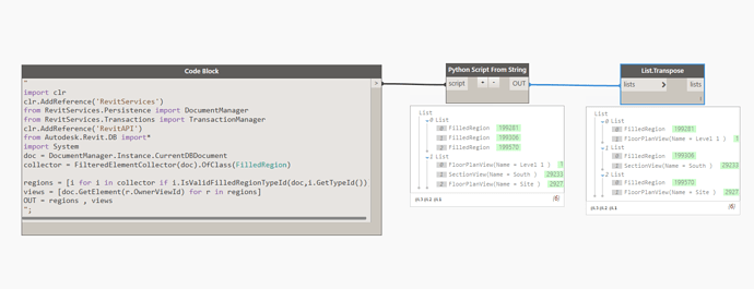

Hi @Daniel_Hurtubise ,
here’s one way to get all filed regions (and no masking region) and the view they belong to :
clr.AddReference('RevitAPI')
from Autodesk.Revit.DB import*
import System
collector = FilteredElementCollector(doc).OfClass(FilledRegion)
regions = [i for i in collector if i.IsValidFilledRegionTypeId(doc,i.GetTypeId())]
views = [doc.GetElement(r.OwnerViewId) for r in regions]
OUT = regions , views
