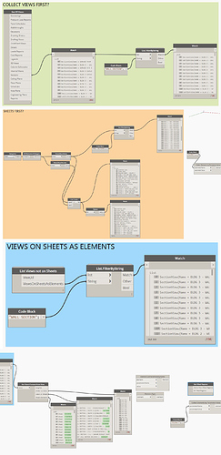

First I started here… (IMG1)

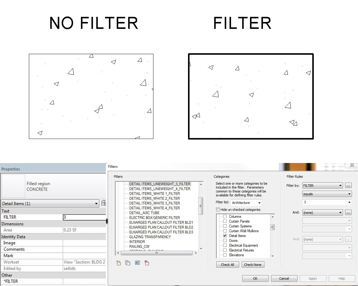

Then I thought I might need to do sheets first… (IMG2)

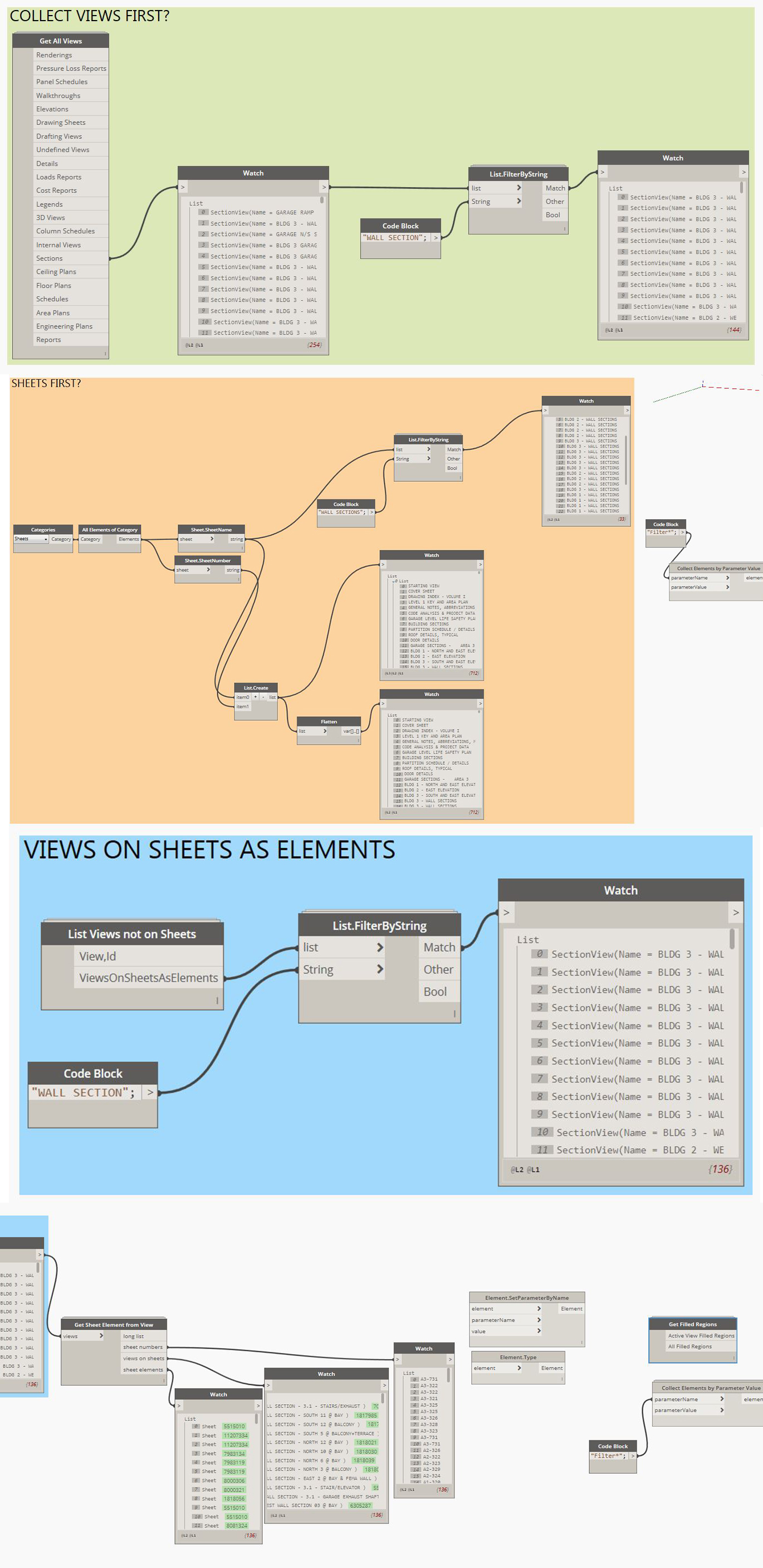

After working through it, I found a awesome node called List Views not on Sheets which really simplified things. (IMG3)

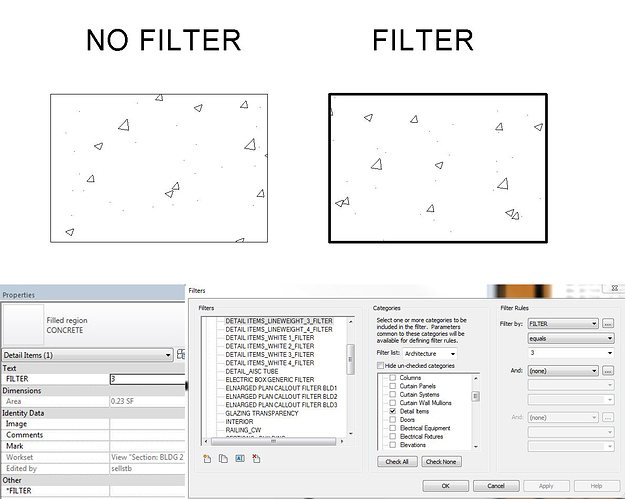

Here’s where I’m currently at… Struggling to get the specific field regions (concrete, metal etc,) within the wall section views. How can I get all the elements I need from the views I successfully filtered? (IMG4
ANY HELP WOULD BE SO APPRECIATED!!

Hi Jacob. Thanks for the response. Here is an image that illustrates an instance of what I’m trying to do globally across sheets.
Let me know if any further clarification is needed.
