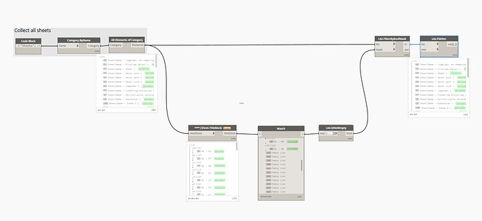

As I’m fairly new to Dynamo i have run into a problem I can’t seem to solve. I have created a graph to automate the creation of sheet sets in our company
Problem I run in to is we have some standard sheets in our template with no titleblock present.
So i need to filter these out, in the attached image you can see I have more sheets in list then titleblocks. Any way I can filter these sheets to a list with only sheets containing titleblocks on them?
