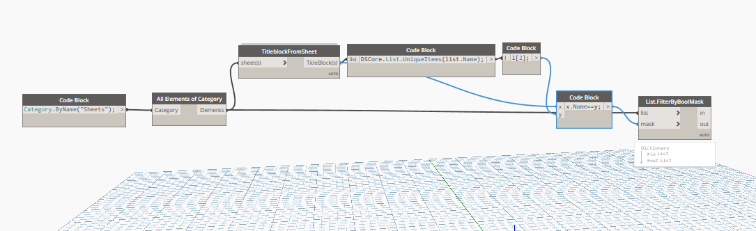

you can try something like this.
You can get node TitleBlockFromSheet in Dynablaster package.
Thank you for the quick reply!
I managed to solve the problem by skipping the Get Sheet Elements From View node and replacing it with the TitleBlockFromSheet. Then I used the sheet list directly (this is what I was trying to get in the first place) .
My pic. was just an example how to filter sheets with for instance A2 titleblock.
I understand, but it helped me get to the solution! That’s what matters!
