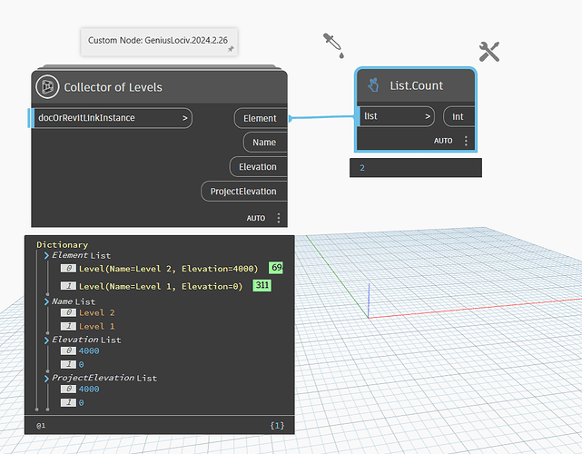

Is there a Dynamo Node that counts all of the LEVELS created in the project?
I tried looking around the forum and it keeps coming back with info on LEVELS in Lists.
I want to find the number of LEVELS created in the project.
If its 5 levels, then it becomes 0,1,2,3,4 and place them in colour range, so that I can Override the Graphic Settings.
I saw guides for doing this, but not on the count of all levels created in the project
This only comes back with a 1… lol
you could try this one here, if i understand ;:wink:
or
View Filter Overall.dyn (62.9 KB)
Thank you very much!
