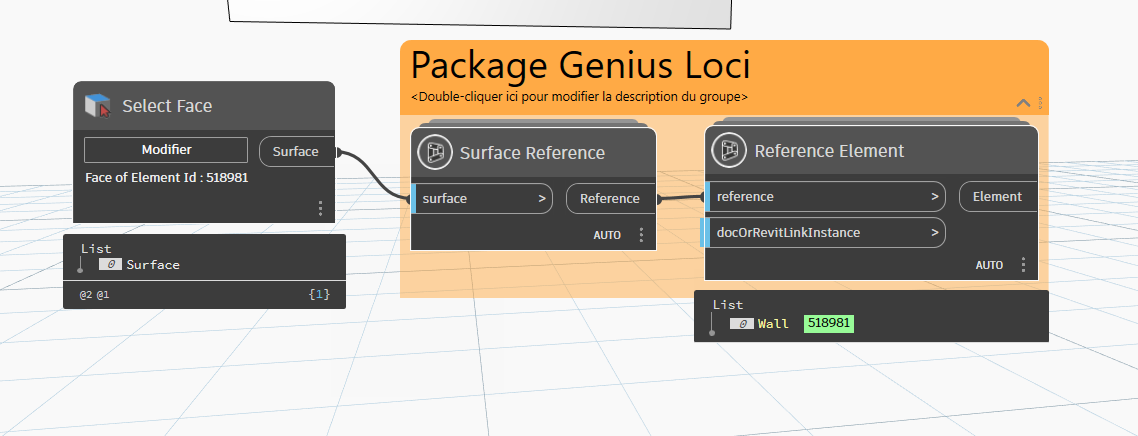

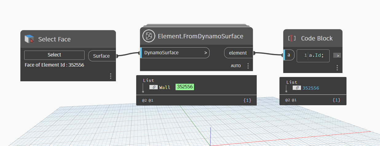

Any idea how to retrieve the ID number (the number that is visible in the selct face node)?
Thanks!
Hi try this one here from clockwork
cordially
christian.stan
Thanks for your reply, that did it.
This one works as well, thanks !
